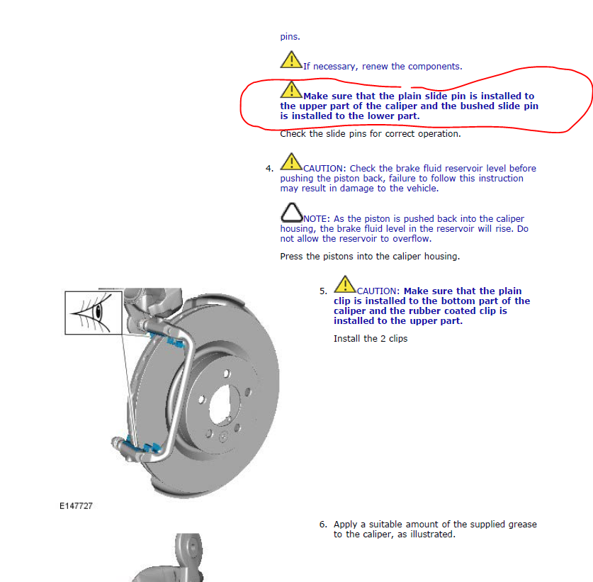

OKay, 24 month service complete at JLR of Tacoma. Fair price and quick service. With 22k miles, the front pads have 5% left and the rear pads have 15% left.
I ask about the rotor specs and was told, "the tech did check the rotors and they were slight above replacement spec so depending on your personal feelings you may be able to do a pad swap"
The full meal deal for front and back was over $2100. That's a new set of rims and tires I've been eyeing for my Burb, so I'm doing this myself. I'm going to lift it this weekend and mic the rotors to check against specs for my own comfort. My question is, any of you do pad swaps without rotors? If so, do you replace the wear indicators? I will go with OE pads, is Atlantic British the best place on price?
Pad swap looks super easy. I did at least 5 pad swaps on my Cayenne S and two rotor swaps, so this shouldn't be much different.
Thoughts appreciated.

Thanks. I'm going just replace the pads. No sense in spending another $400 when I don't need to. I am wondering where the best place to get OE pads for this would be? Anyone have suggestions on best price.
Thanks
1,858
I'd guess either atlantic british or land rover merriam would have the best price on OE pads.
1,403
I was not happy with the brake feel using ceramic pads (less bite). They do however keep your wheels cleaner. Pad swap is super easy but do take the time to clean and re grease your caliper pins. Also it is not a bad idea to swap the rubber grommets on the pin either. Also keep in mind which pin goes where. The rubber grommet is only on one of the pins and LR is specific about which pin has it (leading vs trailing).
The grommets are the bottom two in the link.
http://www.rockauto.com/en/moreinfo.php?pk=3054816&cc=1445215&jsn=372
