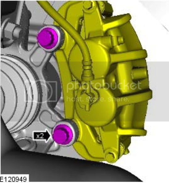

I assume the bolts you are talking about or the brake caliper anchor bolts? 203 ft. lbs.
atlantaM3
Sep 9, 2013
52
Are you sure that is 203 ft-lbs? That is a massive amount of torque for that type of bolt...
