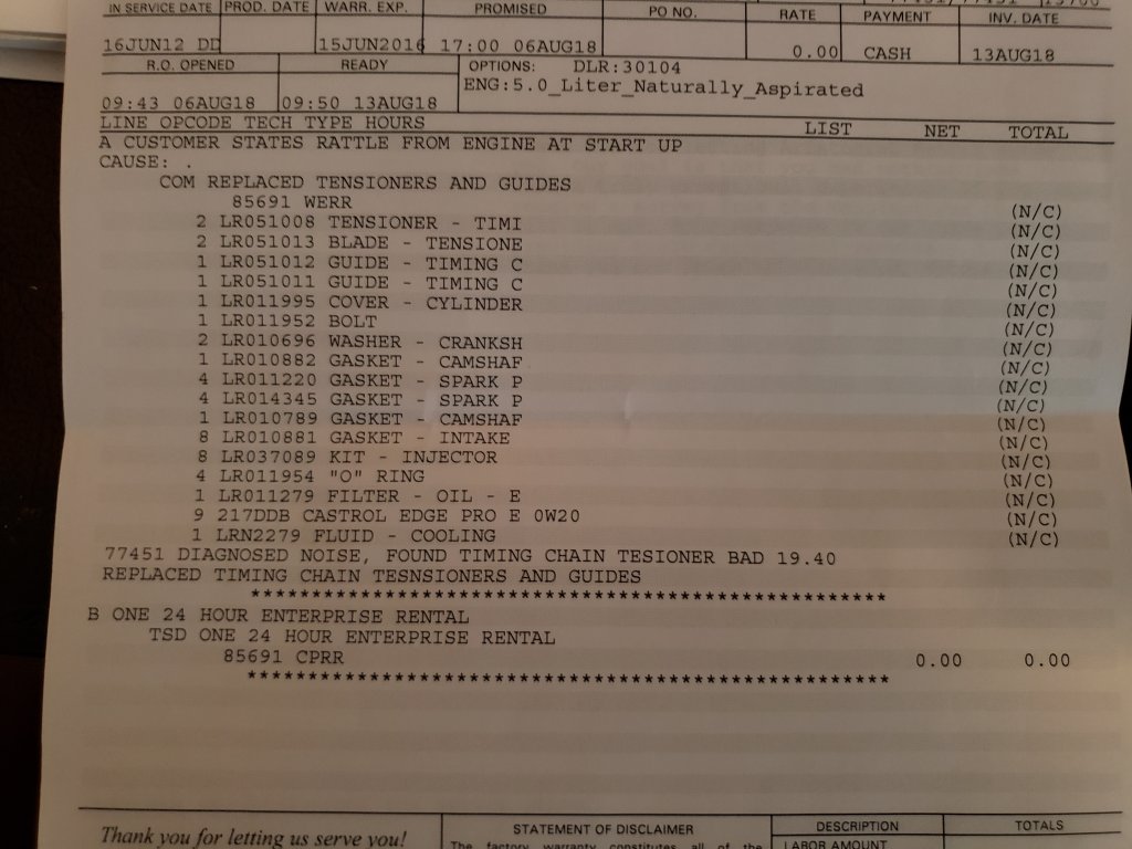

Just got the truck back.. They left the chain in, said it was fine.. They installed the updated tensioners and guides, plus a slew of gaskets and seals.. New coolant and oil. They billed 19.25 hours..
Mike
Wonder if they removed the heads?
What was the final bill?

Quijote- Good call, I stand corrected.. I shot from the full production numbers, maybe the 5.0s were a 1/4 to 1/3 of that..?
All- I need a sanity check on something: RyanJL and I are digging into some of the details of the tear-down of this operation.. I checked the FSM and I'm thinking that pulling the heads is a layer deeper than this job goes.. I think the standard operation is that they pull the valve covers and replace the associated gaskets. Heads would surely require stud nuts and headgaskets..
Here's the damage:

Yeah, looks like I misspoke in this post last week. You don't appear to need to remove the head to to the timing chain job; you need to remove the valve covers to do the whole thing. But it's removing the valve covers that requires removing fuel rails and injectors and thus becomes a major PITA.
Done by the book, the valve covers need to come off to remove the timing chain cover. But some have posted that you can just flex the valve covers without removing them to remove the timing chain cover. So long as you don't want to replace the chain, this is all you need to replace the guides and tensioners.
Looks like they removed PFunk's valve covers, though, going off of the parts used and the time it took.
