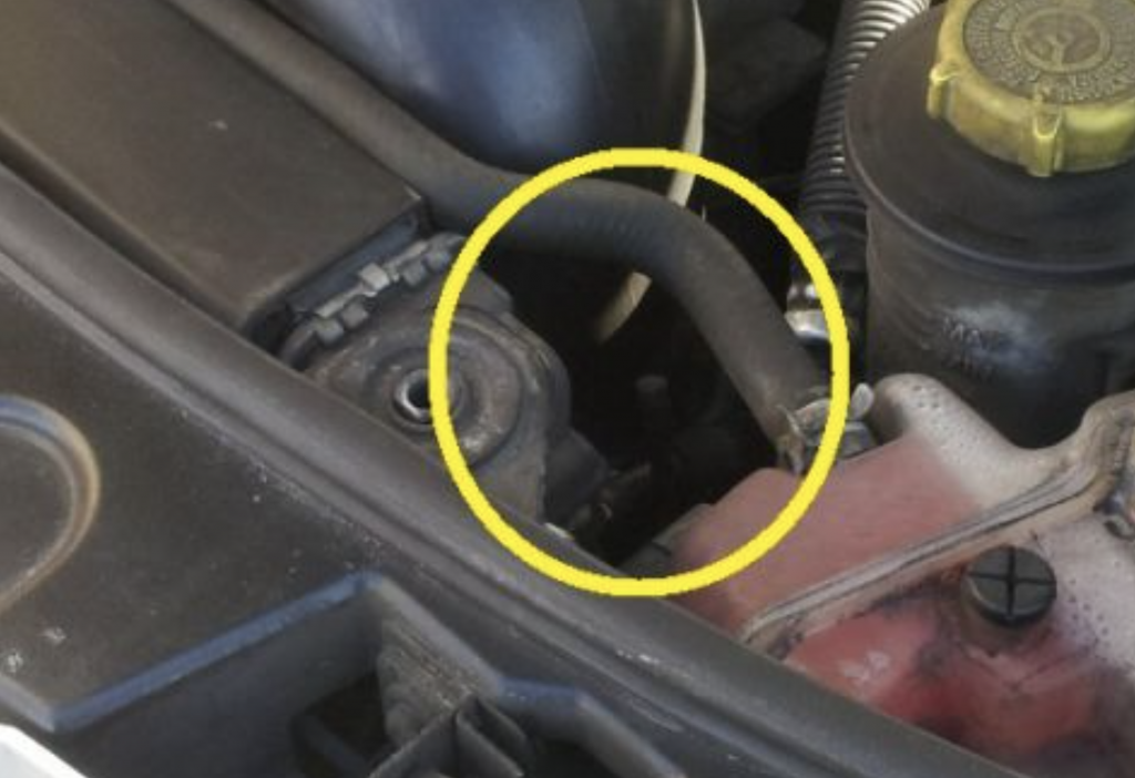

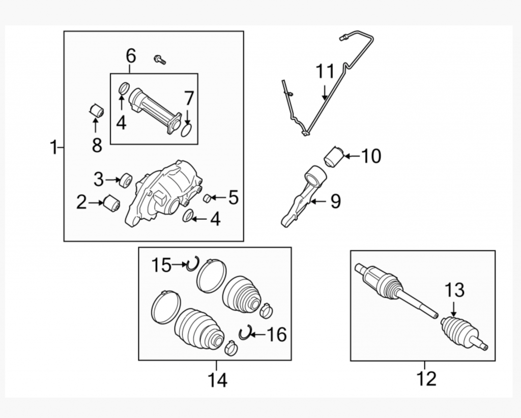

Then there is also the front differential vent hose and this seems to be the one that shows up next to the expansion tank in the engine compartment. this would be more inbetween the wheels, unless those those two vents are actually connected to the same front vent hose?

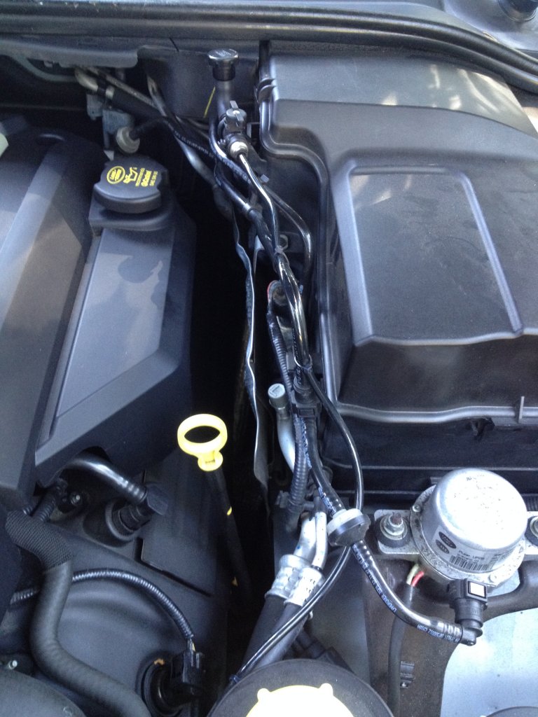

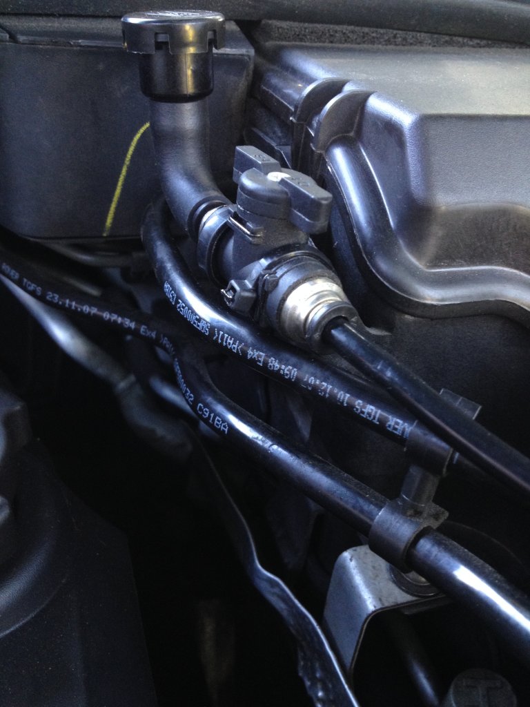

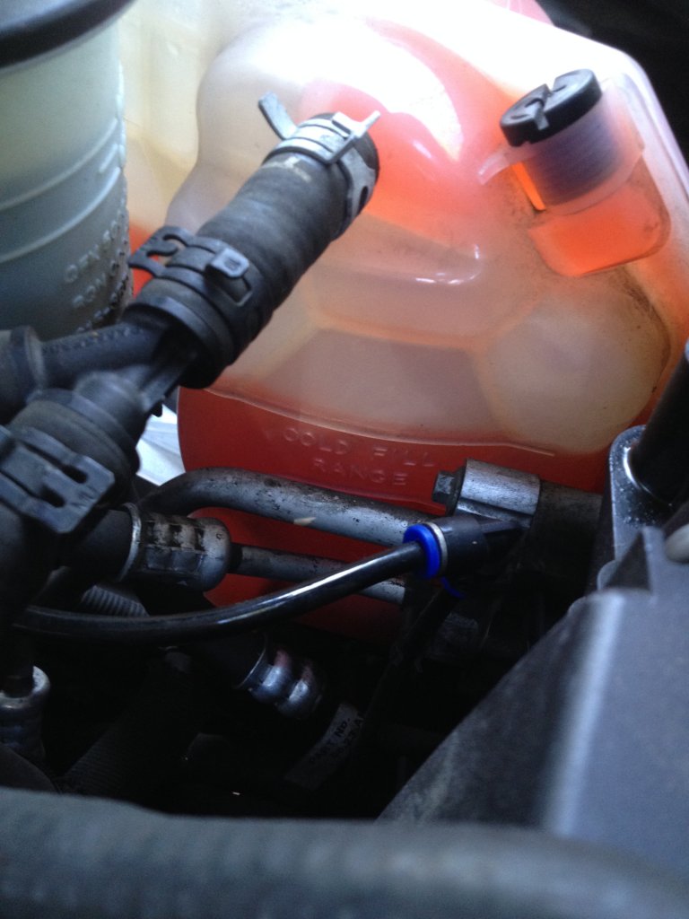

Is that photo of your Rover? If so, you might consider getting the larger updated diff breather cap.
BendRover123
Mar 29, 2020
79
17
USA
General photo and after reading this thread i did thank you for the suggestion, i havent installed it yet but will take a picture once its done. I re-routed the current one slightly back in the engine bay with a pneumatic valve to tun on or off for wading.
