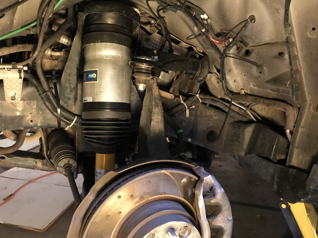

Speaking of all that, tonight I pulled the front struts to install usually non-existent dust boots top and bottom like you see on the rear struts from the factory. Not sure why fronts don’t seem to come with them when it’s a genuine LR part.
Also putting the Rasta aluminum radiator corner guards back (not yet in the photo), then the fender liners and belly plates.
Rerouted the air lines and tucked up the washer canister.
