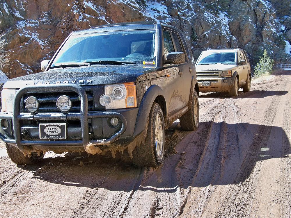

The downside to roof mounted lights is that in really dusty/foggy, or any situation where your vision is obscured is that the lights will just blind you more. Grill mounted lights may be a better option, depends on your conditions.
That being said, hella 500s are a pretty low priced option and come in both a beam or fog style. Can be bought at auto parts store, www.amazon.com, ebay... wherever. The dealership had the wraparound style brush guard on clearence a few months ago, you may be able to pick one of those up for cheap Worked well for me.

You've already started a dedicated off road light thread, I would think your best approach is to keep the info in one thread. I have used Hella's before and for the price, they work great. I have a set on my trail rig, and my tow-rig. The relay's are prone to dieing on you, but you can replace them with much better ones and they seem to last a long time. Never had a problem with the bulbs.

I still need to wire my Hellas... But they look good lol.
