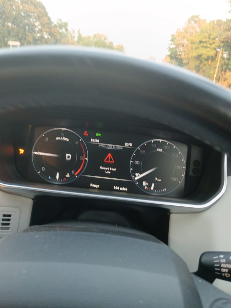

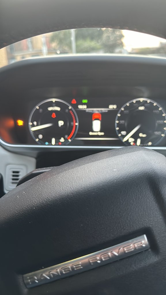

I was wondering if somebody can guide me.
The bonnet warning light keeps suggesting that it’s open. Whilst driving it turns the left passenger front light off with only 1 headlight working. It also says on the dashboard coolant level low or engine oil critically low. - sometimes the bonnet warning light disappears and the error messages disappear. However the light has a mind of its own - sometimes it works sometimes it doesn’t
I’ve had my car serviced so I know it has got coolant or engine oil
Is there anything you can suggest?

Normally for a bonnet error I would say a bad switch, but with your other error happen as well, it sounds like a water issue in either an ECU or some corrosion in some wiring. Either way not an easy fix.
