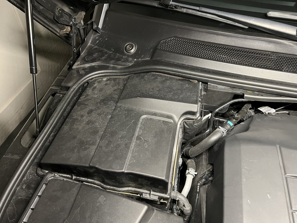

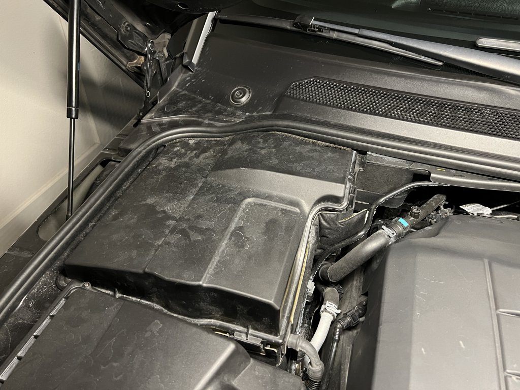

As some have mentioned some H8 batteries are slightly better. For it it appears I can no longer put back on the battery cover. Will this be harmful to the car or components?

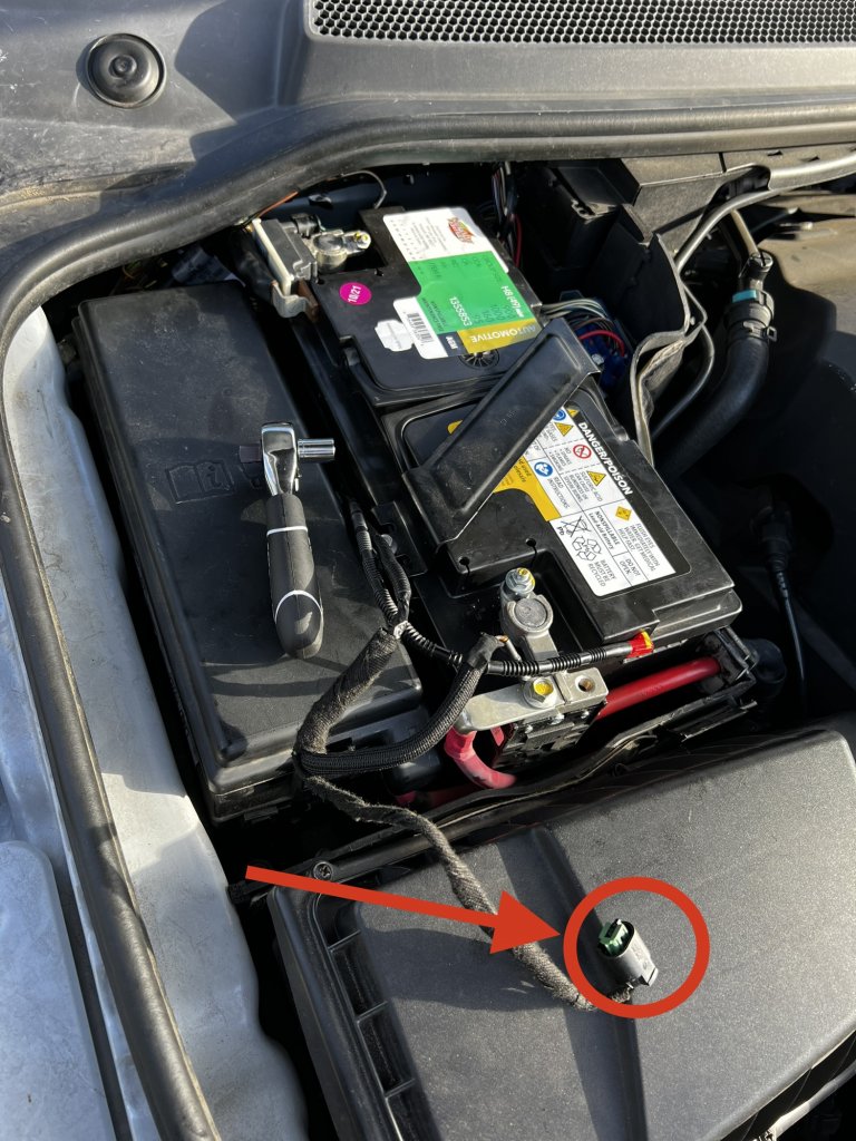

I also discovered a connecter that is not attached to anything. It found it like this before I installed the battery. I’m not getting any error codes and car is seemingly functioning normally. Anyone know where this attaches to? (pic attached)

The battery cover will fit with the H8, keep trying, and figure out what is interfering.
The unplugged connector is normal, you can ignore it.

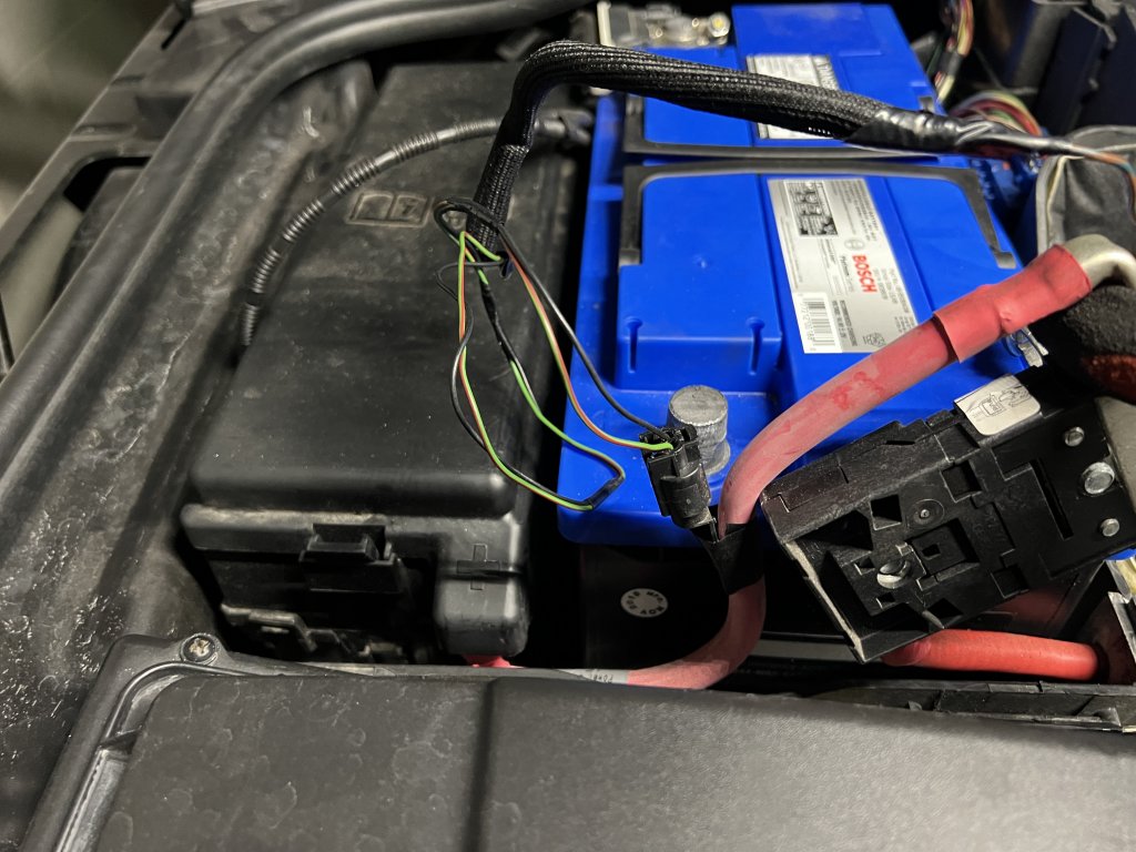

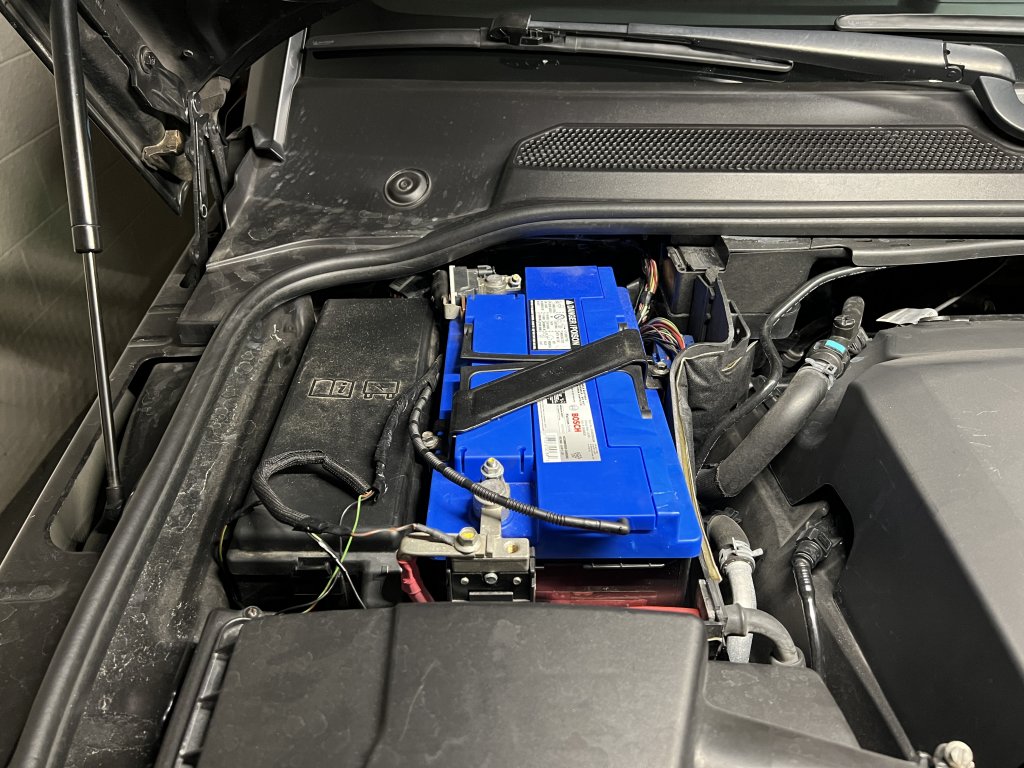

Funny, I was just out swapping my old Bosch H8 with a Walmart EverStart H8 and it looks like that cable doesn't actually connect to anything, it's just taped to the positive battery cable on my LR4:
I was able to close the battery cover on both my H8 batteries (Bosch & EverStart), just took a little extra force :)

From the picture, it looks like you can position the battery more to the front of the vehicle. That will help you with the cover.
Another thing that can help with the cover is to pull the rubber weather stripping from the area around the battery, install the cover, and then reinstall the weather stripping.
