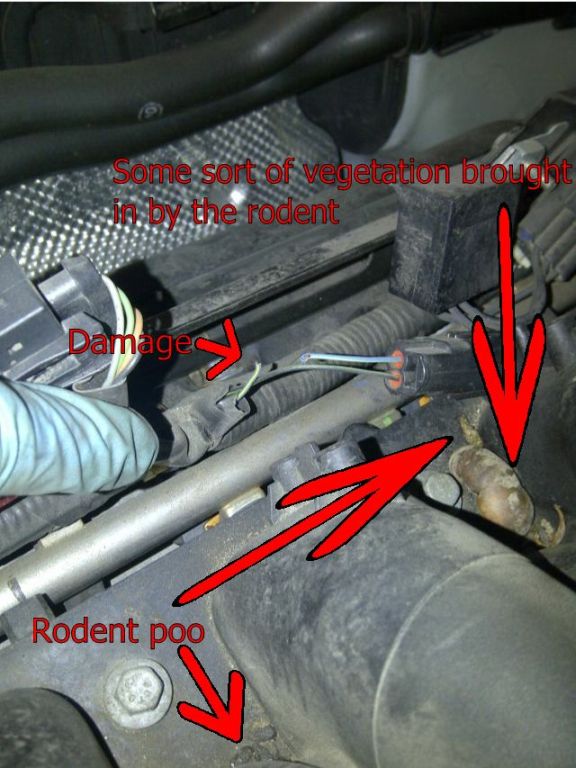

Totally a scenario that I did not think of...
RODENTS..
Apparently, a rodent was probably living in my engine compartment. Took a fancy and chewed through one of the wires that fed into the engine sensor.. so during start up, when the computer is checking the system, it was not getting all of the information from the engine so the computer shuts down the HDC, ABS, DSC, suspension and limits the gears.. there was signs that this rodent was living there. The exposed wire also grounded out by hitting one of the metal parts close to it. This completely screwed up the system. Only cost me $200 for the labour and wire harness replacement (They actually spent a few hours on the exploratory side but only charged me an hour..I can live with that!)
Anyways.. here is the pic:

I park outside on the driveway.. which raises the question, how can I prevent this from happening again? The technician who worked on my car said it is quite common and he recommended that I put mothballs in cheesecloth and stash them in the 4 corners of the engine compartment. So I went to the dollar store, bought a mesh laundry bag and a box of a mothballs (total: $3). I cut the bag into 4 sections, filled them with mothballs and secured them around the engine area (away from moving parts and high heat areas). We'll see if this work. Who knows, my interior may begin to smell like a closet from an old age home..
