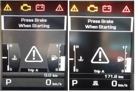

How did you update the instrument cluster? And what features does it add ? I have a 2010 lr4

It's one of the features of the tool either under ECU flash or in the CCF instrument cluster upgrade. it's mainly visual, see photo (courtesy of Gap-Diagnostic).

Does the nav and radio pop up in the screen? Or is it just contrast change.
