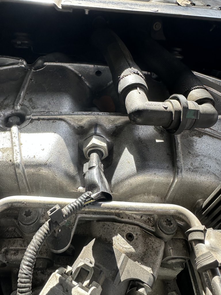

Hey I was wondering if I could get some help I’m trying to take off my super charger for my 2015 range but this sensor on the top I can not get and k don’t want to break it any advice. Also any advice for changing the head gasket m?
