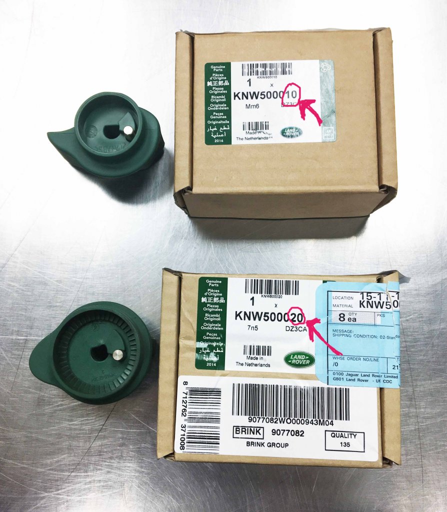

Thought it might be helpful to let everyone know that these green hitch pin handles come in 2 sizes. I recently had the dealer remove and install the green hitch pin on my 2007 LR3 because i had no red key to unlock it.
To my surprise and the dealers, we realized the new off the shelf green hitch pin was smaller in diameter than the one that was removed from my LR3.
**The larger green hitch pin handle is larger and has a different design on the inner round part.
Make sure you order or purchase the correct size.
**Photos attached of both green hitch receiver pins and their part numbers - you will notice the smaller pin part# ends in "10" and the larger pin part# ends in "20"
