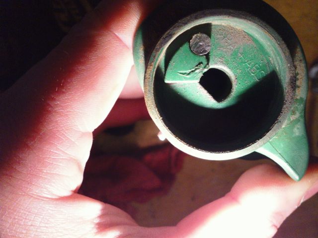

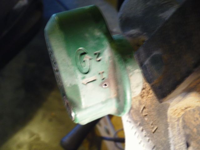

You can see the pin below the number 1. Use a pin punch to drive it out. (or a nail of the right size) then just pull the handle off and you will have pic 2 in your hand.
Use a dremel to cut off the metal round stock. Reassemble Never need a key again. Also BPUTAH sells handle replacements for 30$
