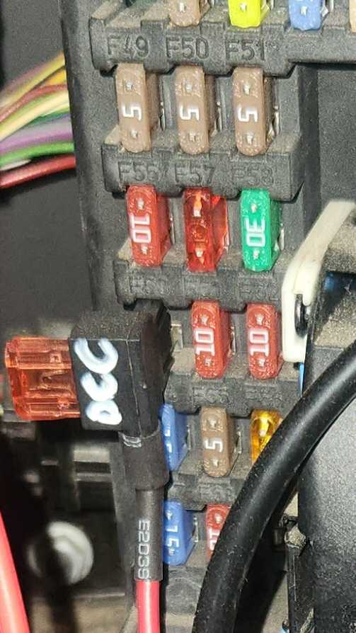

For those that need/want a picture of F60 and the position of the piggyback fuse pigtal, here you go. It's suppose to be DCC for "Direct Current Charger", and the white paint pen made it look weird.
