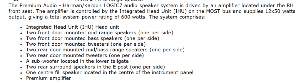

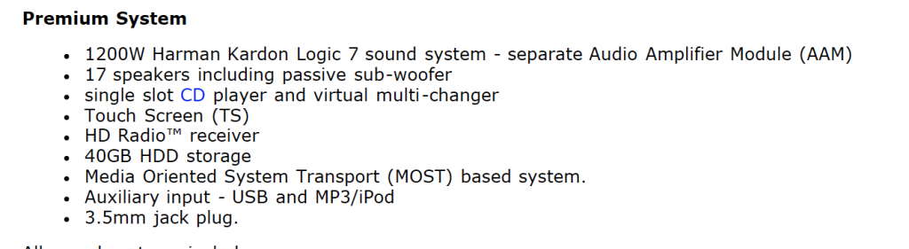

Hey all! Does anyone know the RMS per channel output of the "newer" 2012 1200 Watt system? All I can find in the manual is 12x50watts rms for a total of 600...but that was the "older" 2010-2011 amplifier.
I've looked in both the 2010 workshop manual and the 2012+ workshop manual and this is all I can find:
but then it says:
