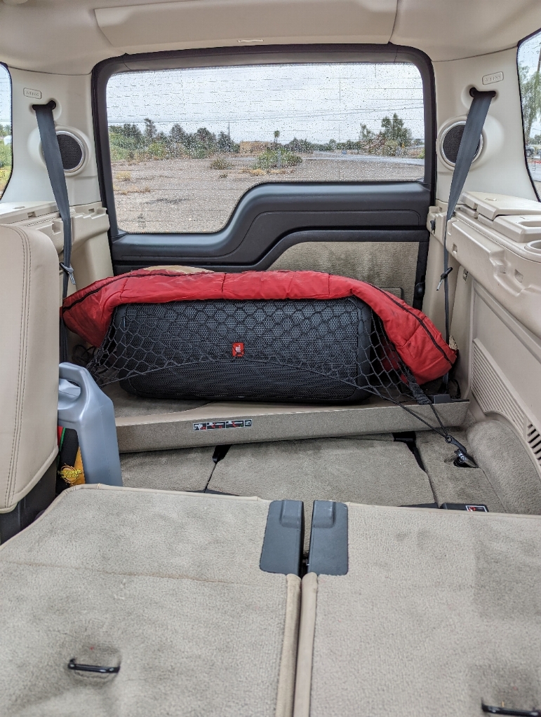

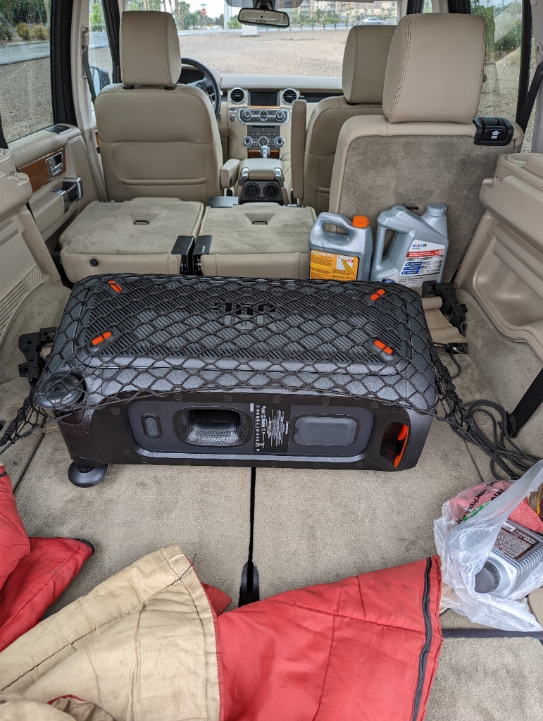

The factory 17 speaker 825W harmon/kardon is fine, but I picked up a portable speaker to try out. It has USB and Bluetooth connections so I've been using my phone to send music to it. Its surprisingly strong, much deeper bass than factory. It vibrates the chest and entire body when the bass hits. It goes down to 20 hertz.
The view looking back at it with the cover on it so it isn't so obvious and the cargo net is gentle enough to avoid abrasions but strong enough to keep it in place:
Rear side with the port on the side. It has a battery to power itself and it has splash resistant covers
Blasting music outside. While working in and around it I can play music w/out draining the car battery. It will be great for camping.

LOL - Didn't know they came in that size. When I saw "bluetooth speaker" I was expecting to see the water-bottle size JBL Flip!

Ha-ha. It weighs 42 pounds and has two 6.5" woofers and 2 2.5" tweeters.

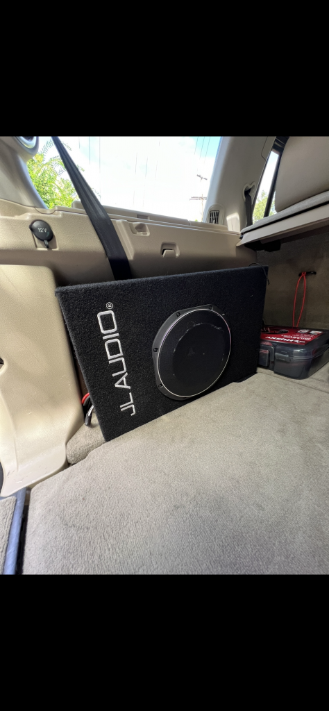

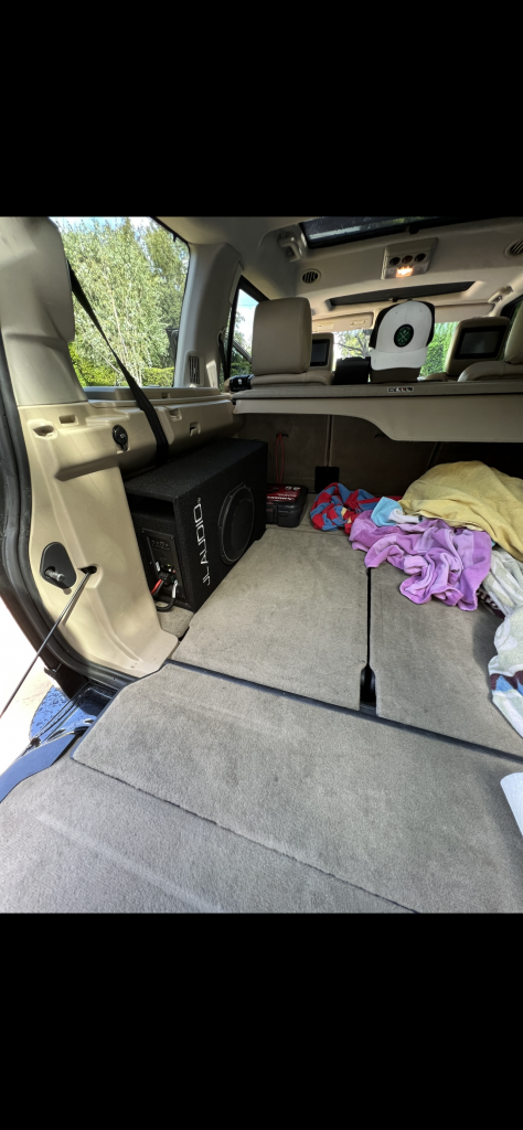

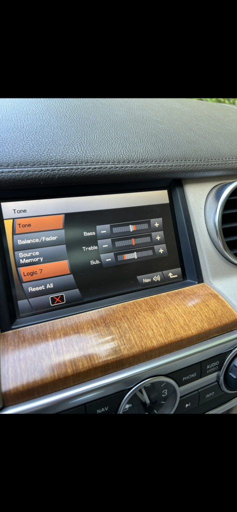

If bass is strictly what your looking for then I would throw a sub in there. I run a JL ACP110LG-TW1, it’s a 400 watt 10 inch sub with a ported enclosure powered by a built in class D amplifier. It sounds great because of the LR4s boxy design and will shake my seat if I crank the knobs. Also allows me to turn down the factory sub a ton to reserve wattage for the high side of the system meaning that I can play my music really loud, windows down with no distortion. It was more than enough for my needs, I have the sub volume turned all down and the factory one turned mostly down. If I need more base I simply turn the factory one up and it automatically turns up the aftermarket one. Easily one of my best modifications.
I also did deaden all doors and the factory tailgate where the stock sun is which helped a lot with sound quality on the normal system. Here are some photos of the sub, I can link you the write up I did if you want to see the door deadening I did.
Only down side is that I couldn’t use one of my 3 row seats but in my case I never used the 3rd row in the last 5-6 years so it was fine for me.

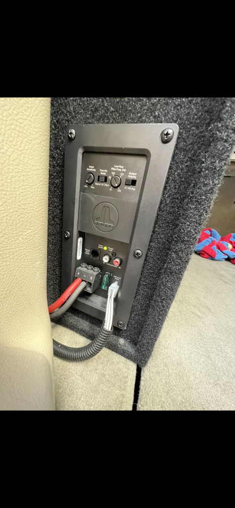

That JL is sweet. How are you giving it signal?

It gets input from the factory sub wires and since the factory sub is in the tailgate the wires are all right there so it was super simple and can be hidden behind the plastic paneling in the rear, unfortunately like you stated you do lose cargo space that you may need for big adventures. You could always unscrew it from the carpet to have that room again but then you get no sub so it kinda defeats the purpose.
