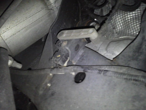

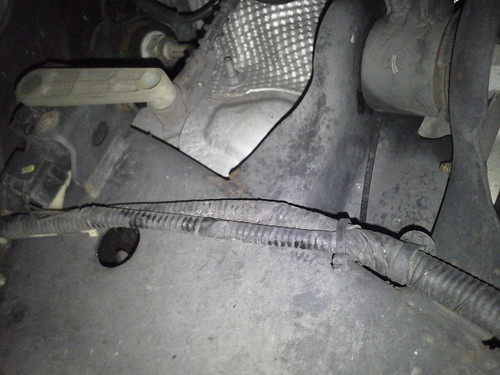

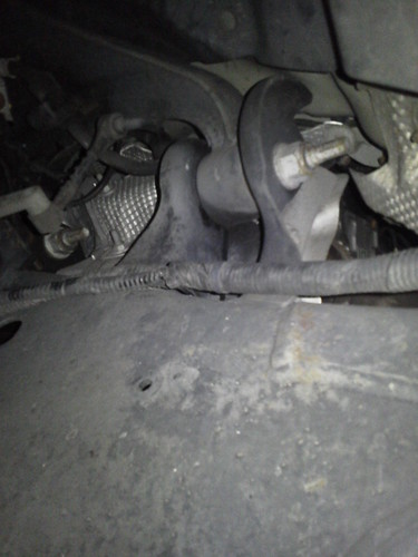

758 by McAnally5954, on Flickr
757 by McAnally5954, on Flickr
756 by McAnally5954, on Flickr
Sensor wire looks good to me.
