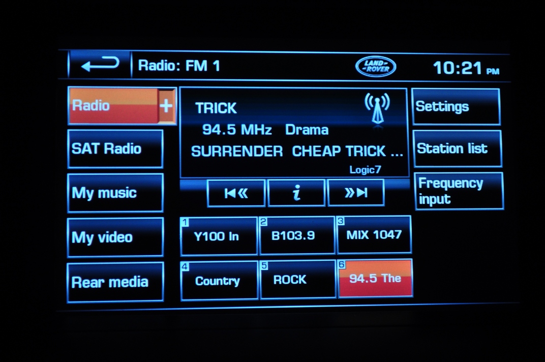

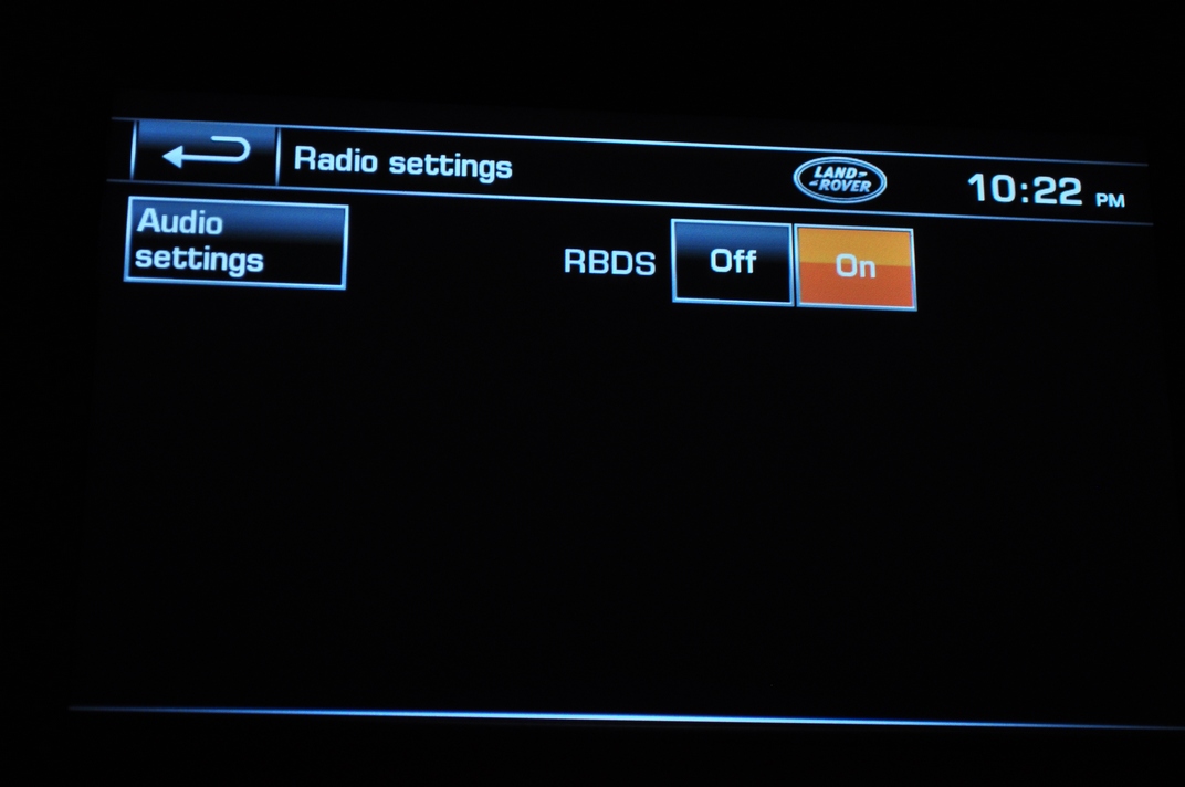

Oct 30, 2011
Pictures
Sorry about my absence from this post. Work got the best of me. I've attached a couple shots of what I get from the FM radio main page and settings page. As I mentioned before, it's a 2012 HSE LUX, so I think something's missing here...

cuteytt
Nov 1, 2011
Mine looks just like Hoosh's pictures above. '12 HSE with SAT but non-LUX.
