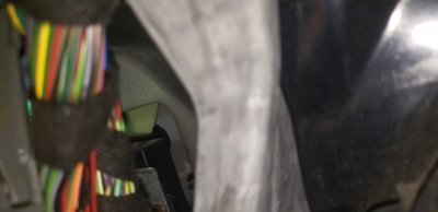

Antenna mounted and wire through grommet:
Wire from behind the lower glove box:
