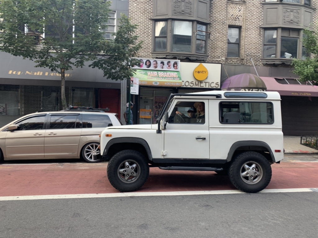

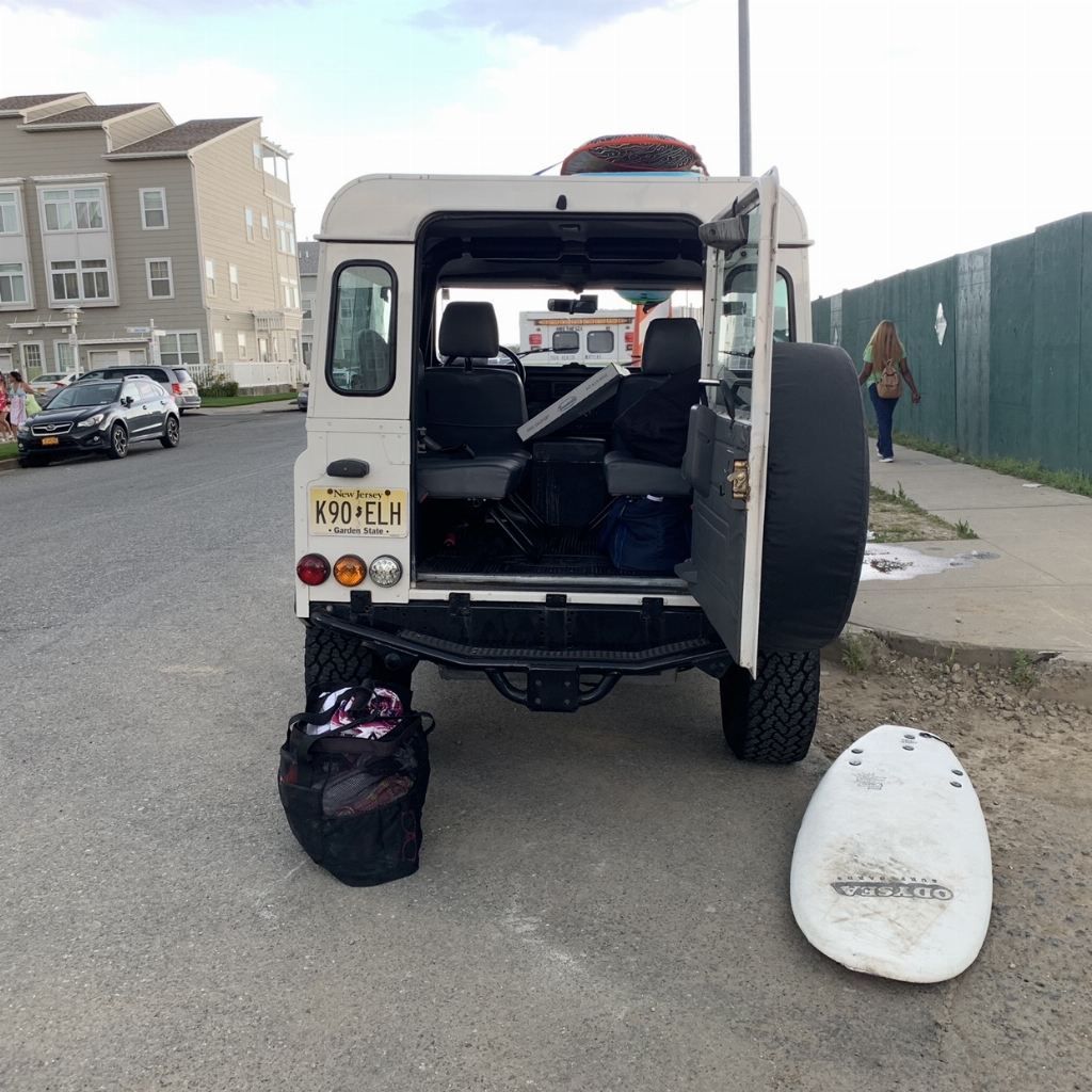

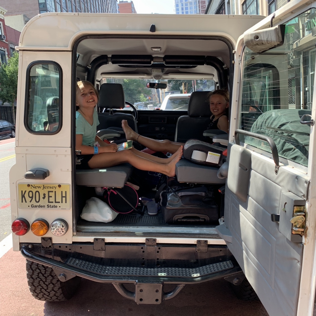

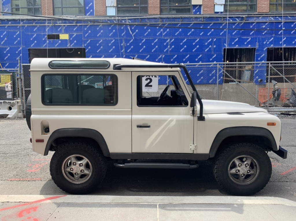

SO the current state is I have a truck body with 118k miles on it with a new engine that has 39k miles on it and all the internals of the tranny with 12 miles on it = drives like a dream. I am happy, did I want to spend 5k? No, but I don't have the luxury of time and with the family needing a vehicle daily to bring the kids to surf camp I needed to make a decision and move forward. Funnily enough my loaner for the past 2 weeks while this was happening has been a friend of mines 1997 Defender 90. Its basically a tractor but OMG is it a romantic ride.
