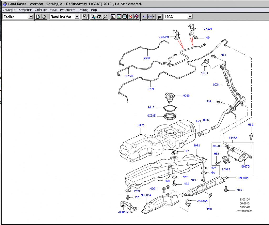

...their LR specialist said it was the filter at the bottom of the fill tube & it required removing the tank to replace. Not having facilities I had them do it for the quoted price of $700, no issues since.
Interesting. I'm not seeing any filter available for the fill tube, unless perhaps it's integrated as part of the tube.
Did the invoice list a part number that was replaced?

I'm about $600 worth of work into trying to resolve this issue on my 2011 LR4 HSE. Replaced a couple of emissions control parts. Could not find a charcoal canister online for sale, so have not tried that. Purge valve and leak detection valve have been replaced. I'll get it back from my local guy today and see if it's fixed. I was also having a small leak in the system somewhere. Could not see drips, but you could smell gasoline. Fingers are crossed here.

I replaced the purge valve and DMTL pump and that worked for me. I still get a CEL that pops up for EVAP, so I might have to replace the charcoal canister eventually but I haven't had any issues fueling since replacing those parts.
Thanks.
Weird part for me is I have no CELs. Nothing pending either. I’ll try the purge valve and DMTL pump and go from there.
