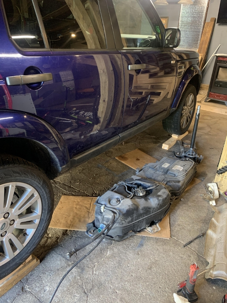

It was straight forward. The only issue I had was with the rear fuel return lines and getting them released above the axle so I could fully drop the tank. I did better on time the second time around.
Are you able to release the lines before lowering the tank, or do you have to lower it slightly to get clearance?

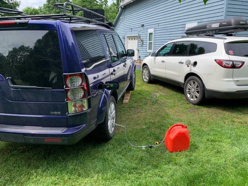

Operation “Fuel Transfer” has started. The new part showed up without a new seal! Anyone know if you can buy the seal separately somewhere? I definitely don’t want to do the job twice.

New seal showed up this AM, and I got it done, was pretty straight forward. Only thing that was difficult was getting that long hose out and back into its spot in the back near the spare tire. The tank is quite an awkward size so raising it back into place was tricky. I drained all the fuel, actually ran out right before I put it in off-road height, so I had to add a little more.
Checked for leaks, so far so good.
