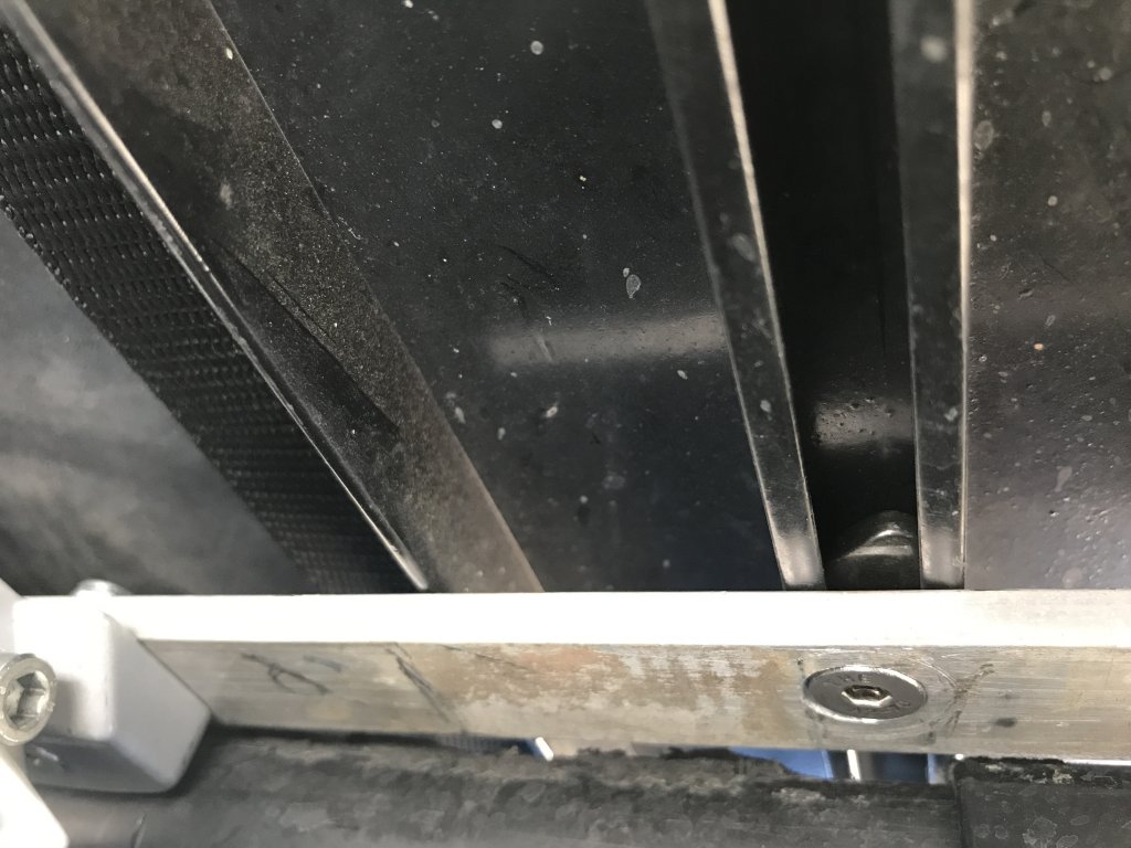

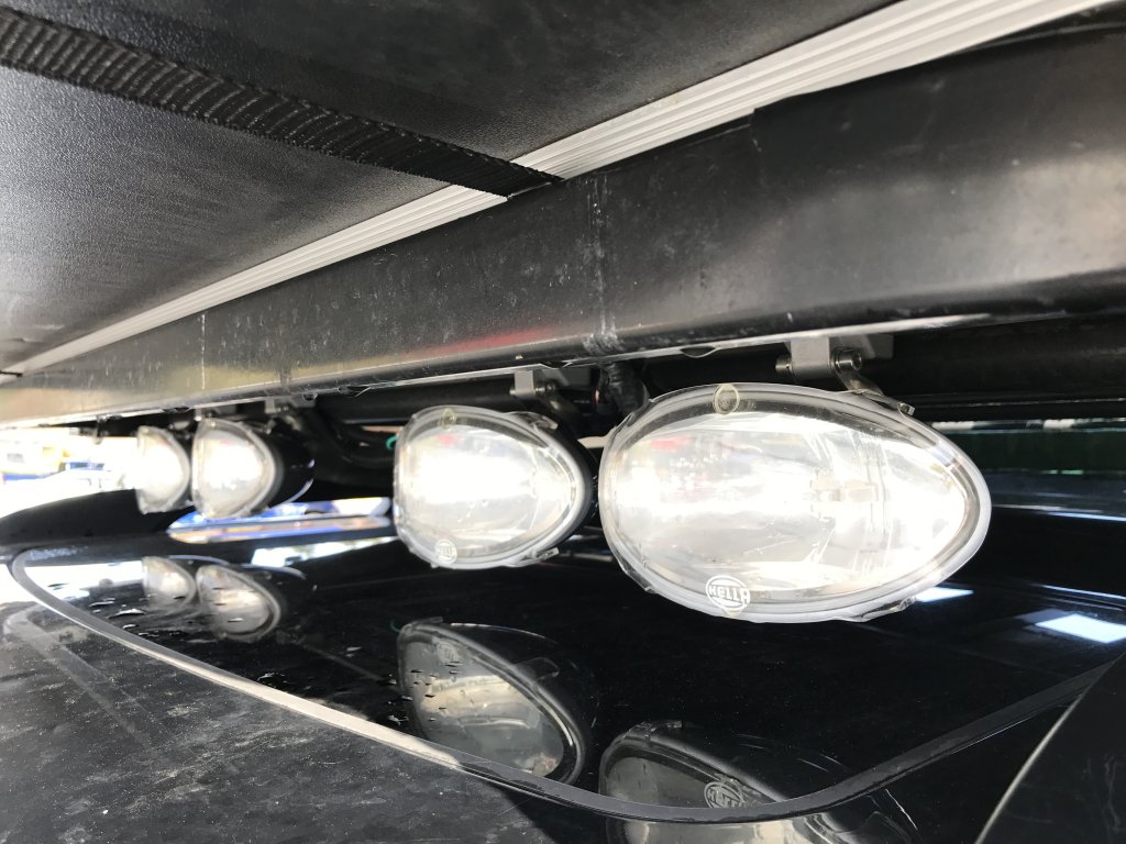

Be sure to use tap fluid. I've been doing a lot of tap and die work recently customizing serious things such as a mount for my flood lights. They are hanging from a 1/4" aluminum strap that is mounted to the underside of the Hannibal rack.

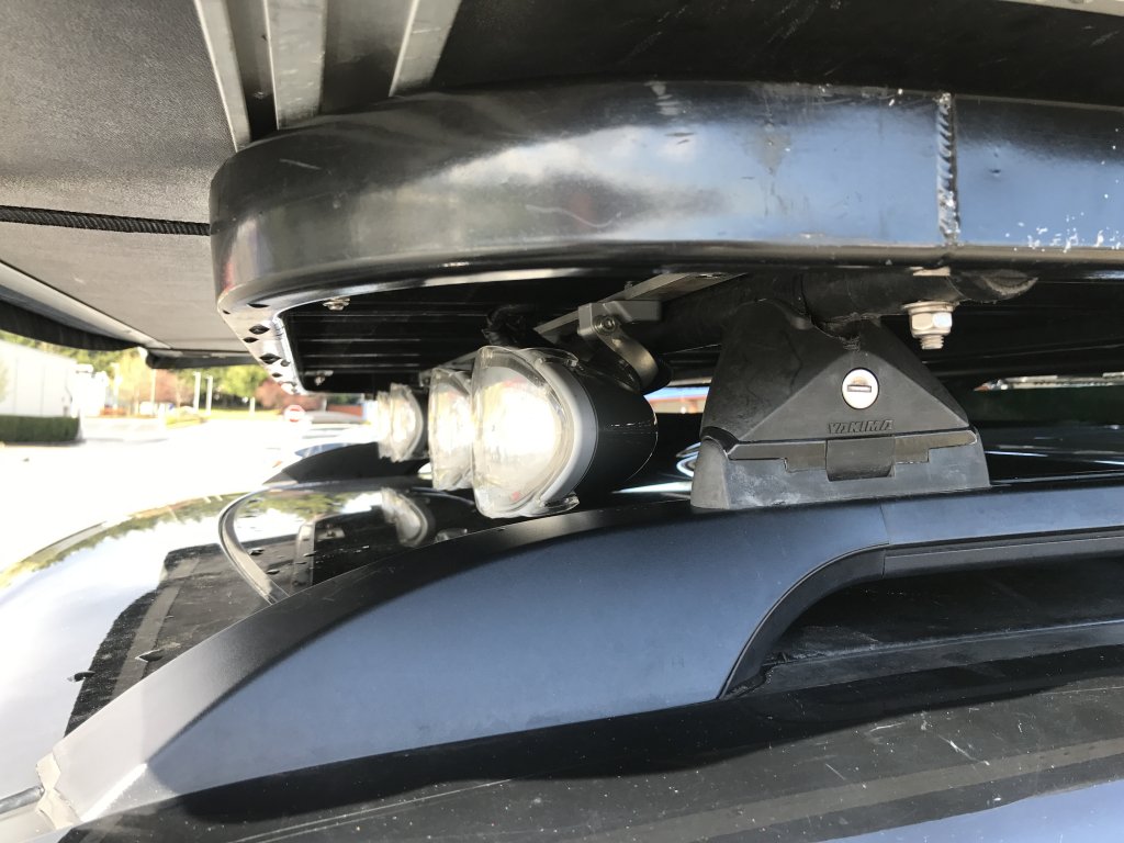

What's cool is there is a slot channel on the bottom of the 4" wide slats similar to the top channel so I used Thule slot rail plates which I threaded into for hanging the 1/4" flat stock.
Then I bolted the 4 Hella lamps from below to that using M5 or 6, with nylon lock nut on top. This arrangement allows left to right adjustment and the lamp itself has up/down angle adjustment.
The whole 4 lamp/mounting strap can be removed now as a complete unit in about 5 minutes. It sits above the sunroof glass but still allows full movements of sunroof. It is however set back far enough to also be protected from branches, etc.
Better detail photo tomorrow.

Todd, Here are some photos to give you ideas maybe on whatever next projects you have.

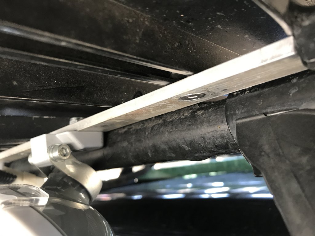

The rack slat extrusions happen to have a slot on the underside which allows the flat slot mounted anchor "nuts" from a Thule tower mounting kit to pop up in there. When tightened they pull flat yielding impossible wiggling out.
The 1"X 1/4" aluminum strap is temporary/prototype and will be replaced with 1.5" wide for full surface contact by the lamp foot. At the time I will also install a hex set screw to ensure no twisting from road vibrations.
