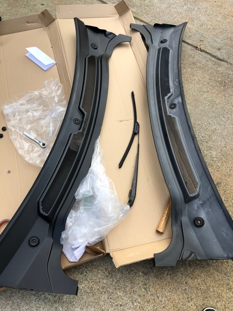

Took me about 15 minutes. And I think it came to 80 after shipping on parts.com. Totally worth it. I've tried the heat gun on the LR3 wheel arches and had decent results but I'm on the fence on whether it's as good as the black dye. As easy as the replacement was, I'd take that over the 30 bucks I paid for the heat gun. It takes some patience. Here is the difference between the two.
Here's the video showing how easy it is to replace.

I'd say the most difficult part was taking off the wipers. I'd say use a rubber mallet instead of a metal one like I used. Even with the cloth over the base I scuffed it a bit. It took a decent rap to get it loose but it also takes wiggling with pressure put in the right direction. He mentions this in the video but it wasn't apparent till I got into it. The spring is pushing/working against you. The clips came out without a hitch. When doing the re-install, the clips popped in really nicely which makes the seal and lets you know they're in correctly.
