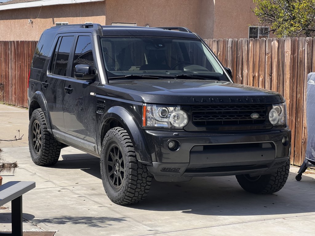

I just put on MT Baja Boss AT 265/65r18 onto Tuffant Kimberleys and have a fair bit of rubbing close to full lock on the corners of the frame horns.
I got two quotes for cutting/welding- one said $150-$200 total. The other shop said 6 hours @ $200/hr which including installing a battery isolator to prevent computer damage and fabricating a new piece to weld on. Second quote seems insane? Has anyone used a grinder to grind down the frame horns as opposed to cutting and welding?
Also, regarding tire pressure, I contacted Mickey Thompson and they recommended running 29 psi front and 33 psi rear, for regular around town driving. Seemed on the low side to me, so I called back a second time and spoke to a different person there and they said the same. Steering definitely feels squishy at that pressure, and I'm seeing here most people running higher pressure. Any idea why they'd recommend 29/33? Should I run higher for around town/freeway driving?

PSI depends on the load range. If they’re load range E, you need to be a few pounds higher than stock to be at the OEM carrying capacity.
