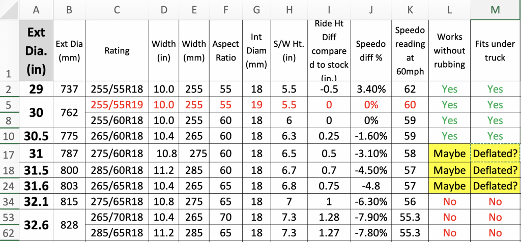

I'm making some revisions to my post and updating / simplifying the embedded spreadsheet as I'm sure more people can make use of this. If any of y'all would not mind helping can we all pretty much agree on the highlighted cells here, namely that 30.5" ext dia. tires and smaller fit without rubbing AND fit under the truck, that 31-31.6" dia tires MAY have some rubbing and MAY have some tightness under the truck, and that once you cross over into the 32.1 and higher, you will definitely have rubbing and also will not be able to fit the spare under the truck? I know this has been beaten to death but I can only read 90 pages of forum posts so many times. :) Hoping to make this a permanent useful post for people.
So my 265/65s (as mentioned) did have slight rubbing at full lock but the spare fit underneath without deflating (just as long as the hitch was removed for the install).
How much of what tire rubs where is wheel dependent though? LR3/Compo/Tiffany etc...?
That sounds more familiar - I'll set it so that the 31-31.6" ones fit underneath and will replace "Deflated?" with "Tight".
Did you have ro remove the heat baffle or not? I know some people did that maybe in tandem with deflation to sort of jam a spare wheel/tire combo in there.
To answer your question, I'm not sure that the wheel itself is the critical determinant. From all the posts / forums I've read it seems to be more of a function of the tire width (rubbing) and diameter (storage underneath.)

Thanks for the writeup, Troy. Very useful. I wish I had this to refer to last year. Just FYI, 31.9 fits on the lr4 with very light rubbing and the spare fits in the compartment, deflated. So you can flirt with 32 inches and still be OK.
Thanks. I wish I had this article myself! I will update my next version with those changes. Thanks again!
