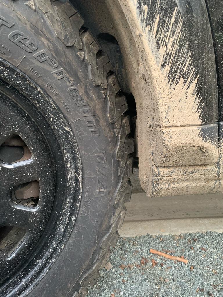

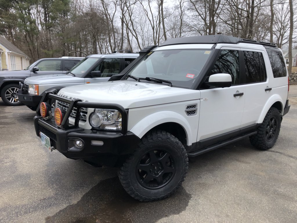

Hey All,
New to the forum and wanted to share the results of my wheel and tire upgrade. I read nearly every page of this thread before deciding which route to go. There is obviously a lot of great feedback and opinions to sift through, so thank you to everyone who has contributed. I figured sharing my results might help others with their decision making process.
  • 2016 LR4
  • Compomotive PD1881 on KO2 265/65/18's

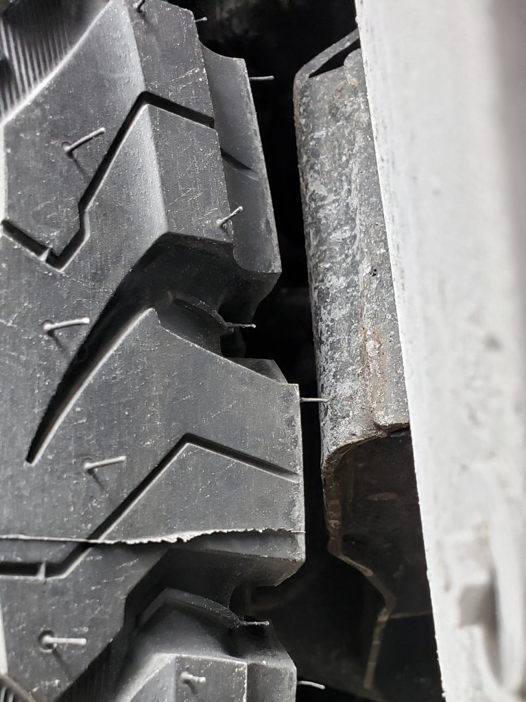

  • There is no rubbing on the frame horn (see pic below) nor on the wiring harness at full lock but it's really close on the frame horn
  • Each tire, except the spare, has a TPMS sensor. I didn't want the spare setting off the warning and will carry a compressor in the car
  • PSI is set to 46 front and 50 rear. The ride is not harsh at all and road noise on the highway is no worse than the stock wheel / tire combo. In fact, I prefer the ride of these KO2s

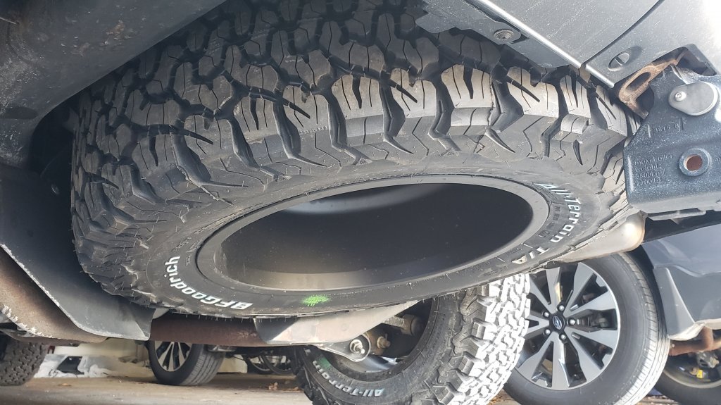

  • I also aired down the spare and it fits just fine without removing the heat shield and there are no clearance issue with the hitch
  • I used my stock lug nuts because they were already powder coated satin black
  • I have some black center caps on order from ebay
While I was at it, I also replaced the stock side steps with Proud Rhino rock sliders. Install was pretty simple and the only requirement was to trim some plastic.
I installed the Prospeed roof rack, rack floors and ladder a couple of years ago. The rack was super simple to install but the ladder required some unexpected drilling and elbow grease to get into place. I would do both again.
Thanks to everyone who has contributed to this thread and big thanks to Erik over at Lucky 8 for the great customer service as always.
Craig

Looks great Craig.
Surprised you don’t have any rubbing of frame horns at full lock as I did (though my install was with the LR3 wheels and spacers).
Camp Craig
Mar 8, 2020
7
PGH
Looks great Craig.
Thanks! At full lock, yea, there is not much room as you can see by the 3rd pic. Definitely cutting it close.

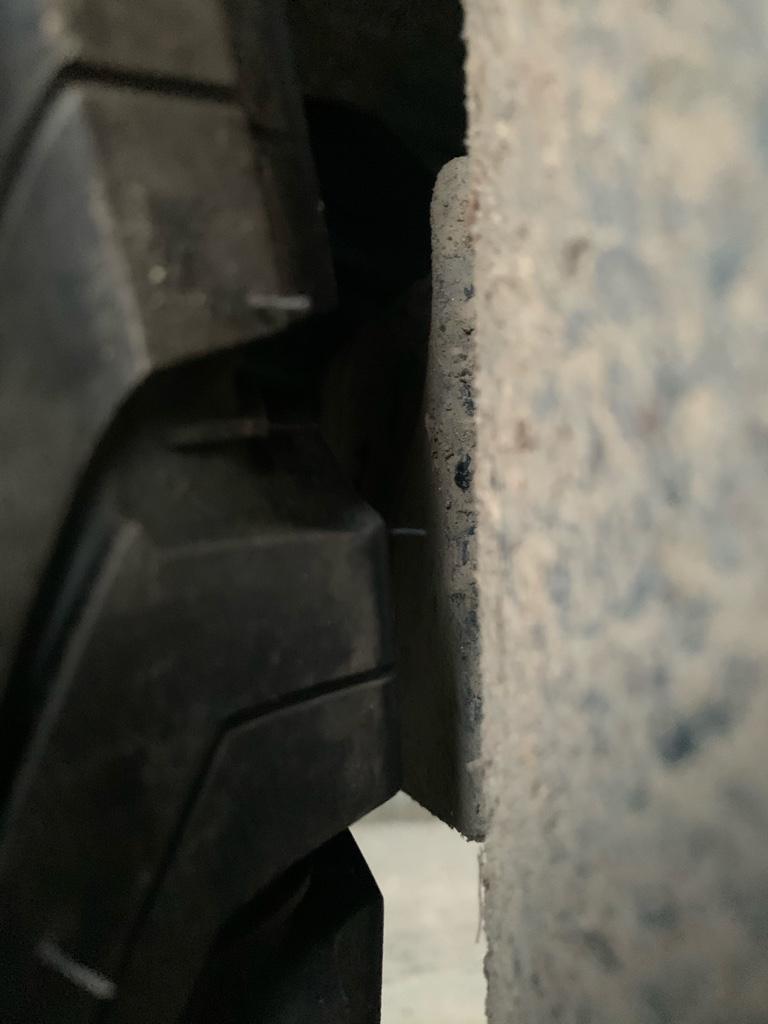

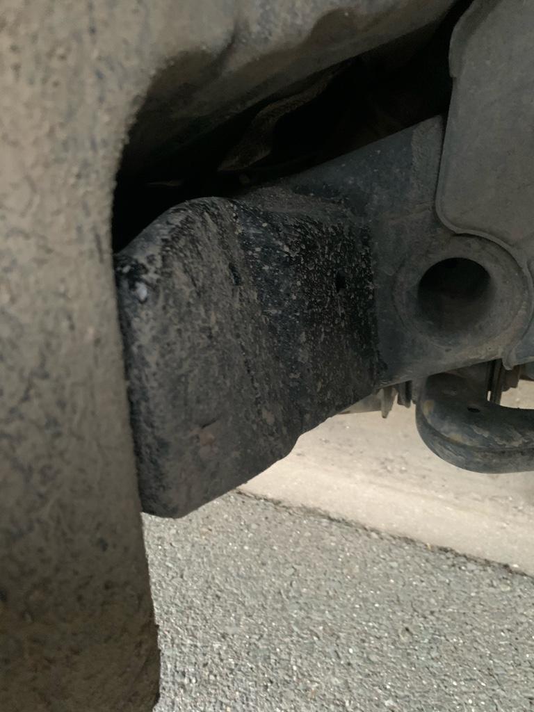

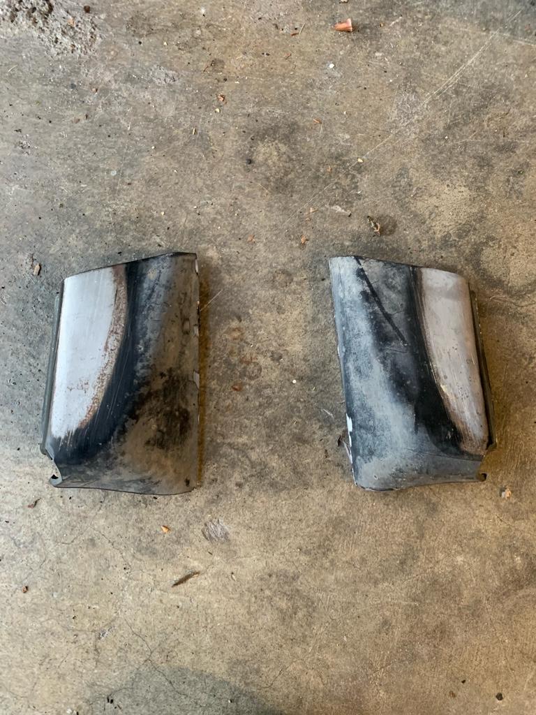

Running 275/65r18
Needed to cut the frame horns as I experienced significant rubbing at full lock.
Got the frame horns cut flush with the wheel well. Excuse the dirt in the photos.
At full lock:
36,711
222,687
30,886
