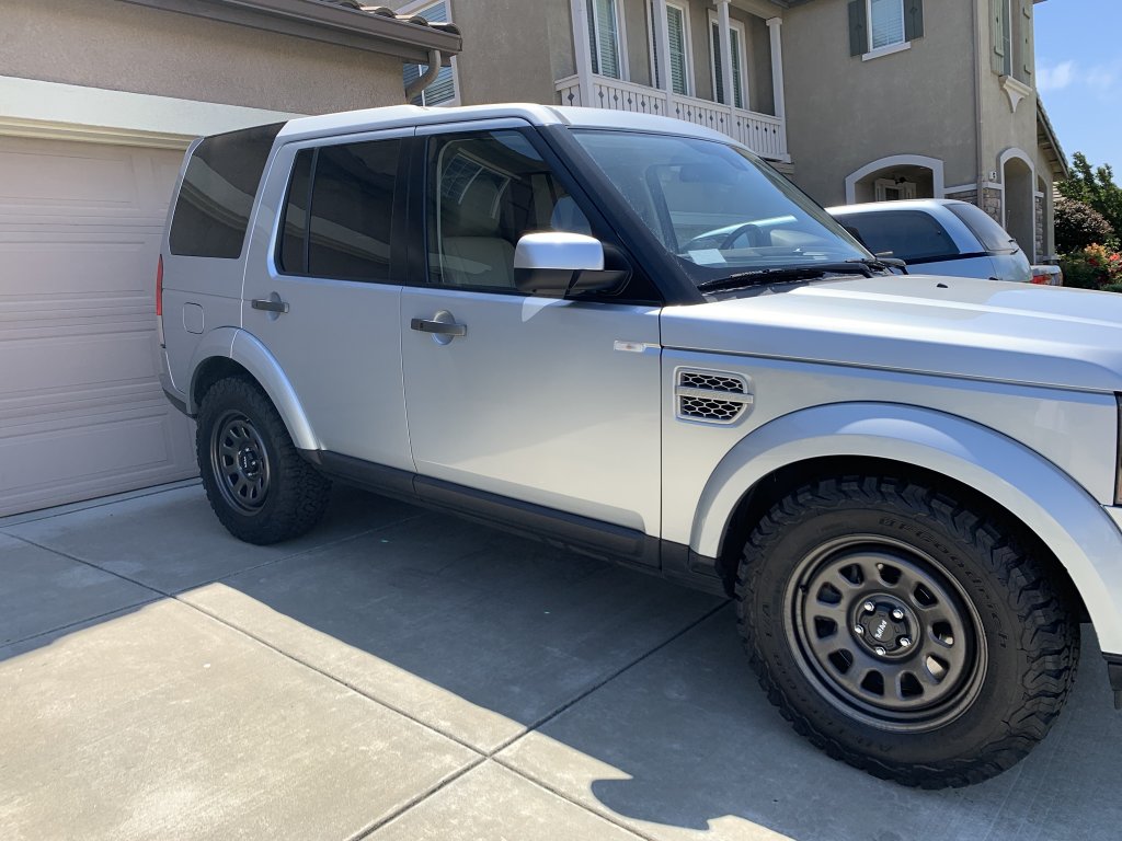

I'm a new 2010 LR4 owner and got the TuffAnts with KO2s, 265/65/18 (they rub lightly only when in full lock to the right in reverse, weird specificity).They are several hundred dollars cheaper than Compomotives and also do not require spacers unlike the LR3 or Lucky 8 steel wheels. Plus, I like the look of them.
New wheels should come packaged with new lug nuts. I did not install TPMS on the new wheels, but turned off TPMS using the GAP Tool so no tire pressure warning messages.

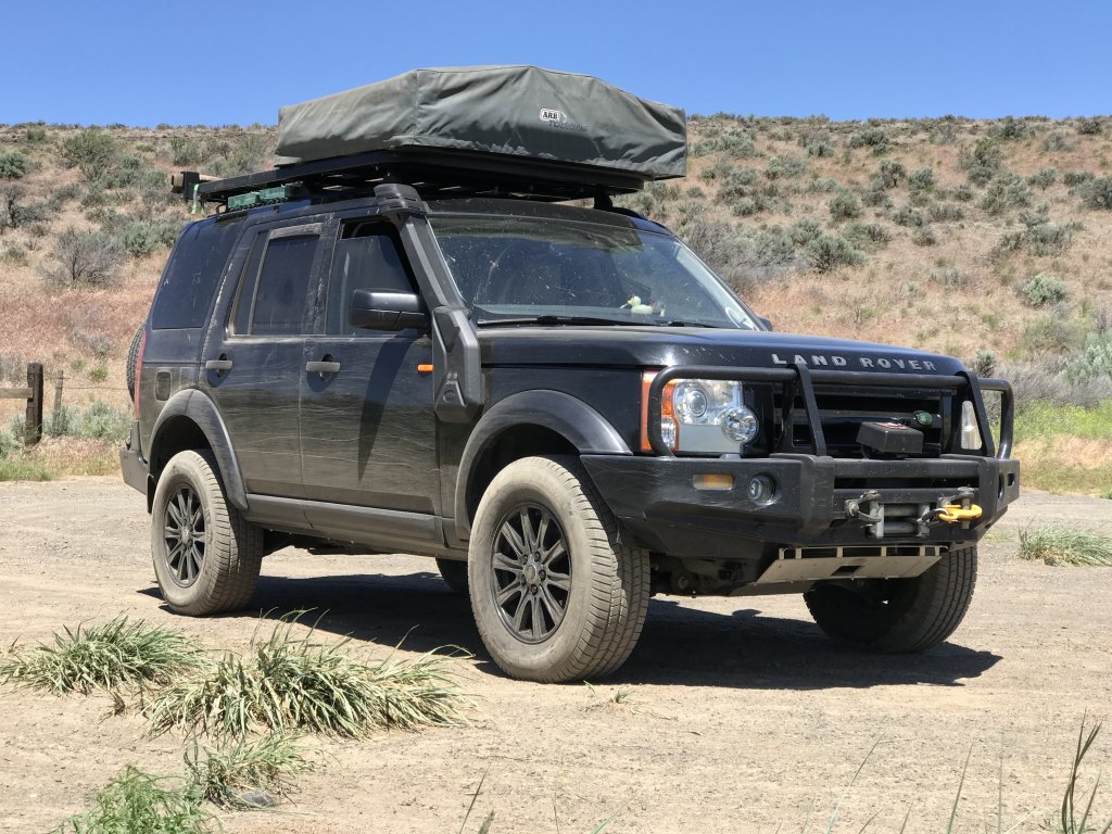

None of those LOL ;) I did use the Nitto briefly. To be honest, all those are 'meh' for the use you describe. I used to think I needed SO much tire, tough, aggressive, etc. Then a few yrs ago I decided to see how little I could use to do how much.
I chose the Michelin MS2 (there are others similar) which is basically an all-around tire perfect for long road trips that also see days and days of extended forest road use. I know they won't do as well in actual mud but I tried them first on dry days here in the PNW on ORV park routes which are more likely to take out a low profile tire than any "overlanding" routes you usually see photos of. I did get E load due to my lr3 weight and lowered psi to 30's and 20's for these test runs.
Another time was a rainy wet day but mud is not the same as just wet. These do perfectly fine with everything wet due to the tread but deep mud is different of course.
I've now done trips WA-NC-Ontario-BC-WA and has snow, gravel roads, etc, even slo-mo rock crawling and this unassuming 'highway' tire has been fine, which is kinda funny when I have a stack of BFG KM2 to choose from as well.
Back to your post though, the km2 is almost 100 lbs wheel and tire whereas the Michelin is closer to 80. The tires are 14 lbs different and the factory wheels are also about 5 lbs different from the flat 10 spoke to the 'flutted' ten spoke. The KM2 is an almost 34" 285/70-18 and the Michelin a true 32" 275/65-18.
(The tire was LTX MS2 but is now the Defender version)
The michelin does feel sportier than the big km2 which is the weight and the size.
FYI, a tire like the Michelin Defender has load types in the 116 range which is a nice compromise.
