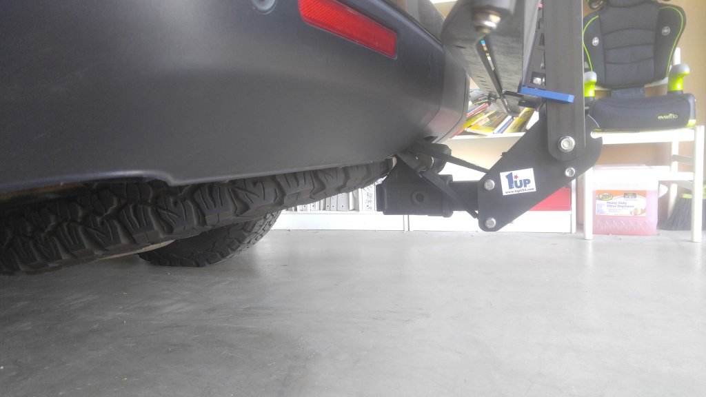

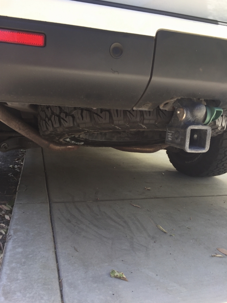

Was referring to mounting hitch with large tire stowed under. The new hitch protrudes into the spare tire space so it's either one or the other. Not both.
As for larger tires a swing away is ideal but not everyone has one nor wants one.
TLB
Feb 11, 2011
290
21
The hitch is still a plow.
It is not necessarily "one or the other".
You can place your spare under the truck ( 265/65/18 in my case), then attach LR hitch. Of course you will have to remove the hitch to access your spare, but it is easy and quick. Incovenient?., yes but how often do you have to do this?. I do not tow but you still will have to disattach a trailer before jacking up the car and changing a tire, so removing LR hitch at this point adds 15 secs to the process.
For me more hassle is removing a bike rack when going to a car wash. The good thing is 1upUSA rack is "user friendly".
