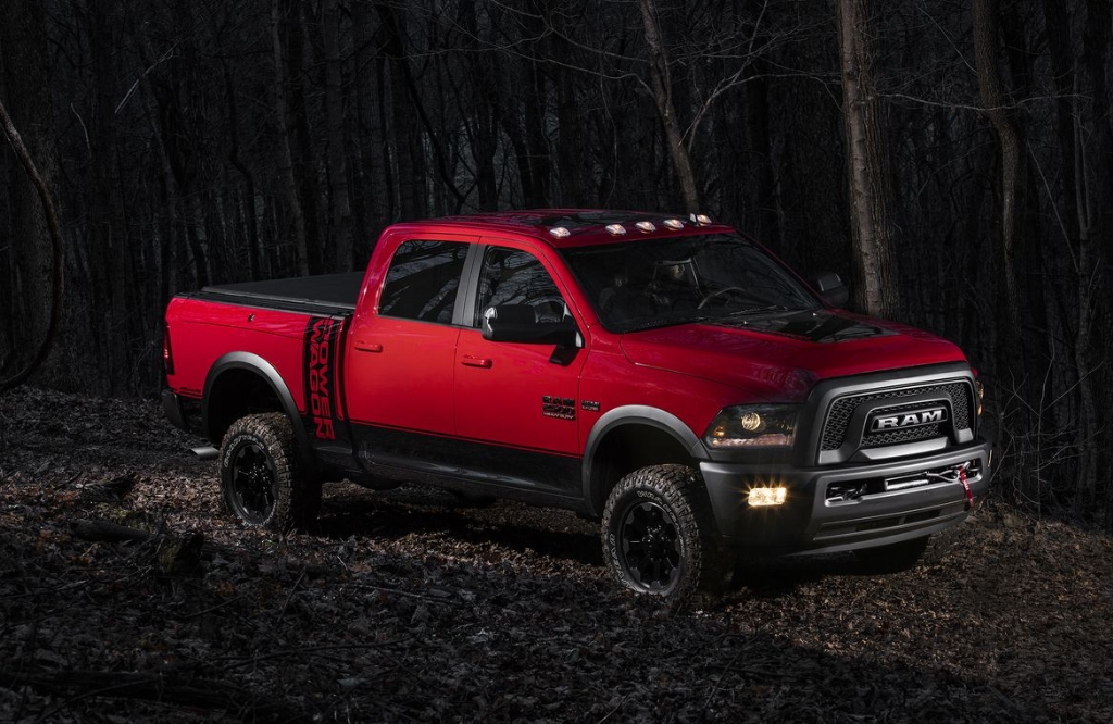

From the pictures, it looks like the Duratracs come standard on the 2017 Power Wagon. Nothing drew the ladies in the 80's like a Simon and Simon Power Wagon ;) (well maybe a Magnum PI Ferrari)
They should make that "battering ram" on the front an accessory for the 2017 model!
