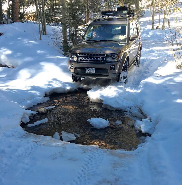

Drove up into the "foothills" today to try out the KO2s. I inflated them to 46/50-ish (may have been 51 as my gauge is analog and not that easy to read). I drove 65-70 on the interstate. 55-65 on a fair bit of "highway" then did a bit of offloading including some snow and ice work. (See below)
I love the tires. To be honest, they did not "feel" that harsh at those pressures. My wife an I didn't even notice the tires and for the past 4 months we have been running Nokian snow tires that, with the 60-degree weather we have been getting, are probably a bit soft. I might bump up the front a bit after I get my sliders on tomorrow. And I'll increase the rears to maybe 55 when towing this summer. But I have not done any scientific tests. I am simply going off of what bullmrkt and Finlayforprez do and land somewhere in between. I expect David's LR4 is a fair bit heavier than bullmrkt's!
In the picture below I am about to enter a very shallow stream. The trick was that both banks consisted not of rock but an ice shelf. So I need the tires to "climb" the ice or at least get enough push from the tires in the stream. The ice shelf that you can't see, the closest one, was about 8-9" high. When I hit the shelf the tires spun for about 1 second and then I was up, out and through. By the way, 20' to the left of the picture there was a bridge I could have used. But that wouldn't have tested the tires. :biggrin:

Hello Dan,
Thanks for the post. I am very happy to hear you like the KO2s and had a chance to test them out both on and off the load. I had the original KOs and was pretty impressed, but BFG really did an excellent job improving all aspects of these tires with the launch of the KO2s.
I loved your photo and description of the terrain, very cool! Let's continue to see where we land with optimal pressures and see if we can help each other land on just the right numbers. Your experience has been very helpful.
