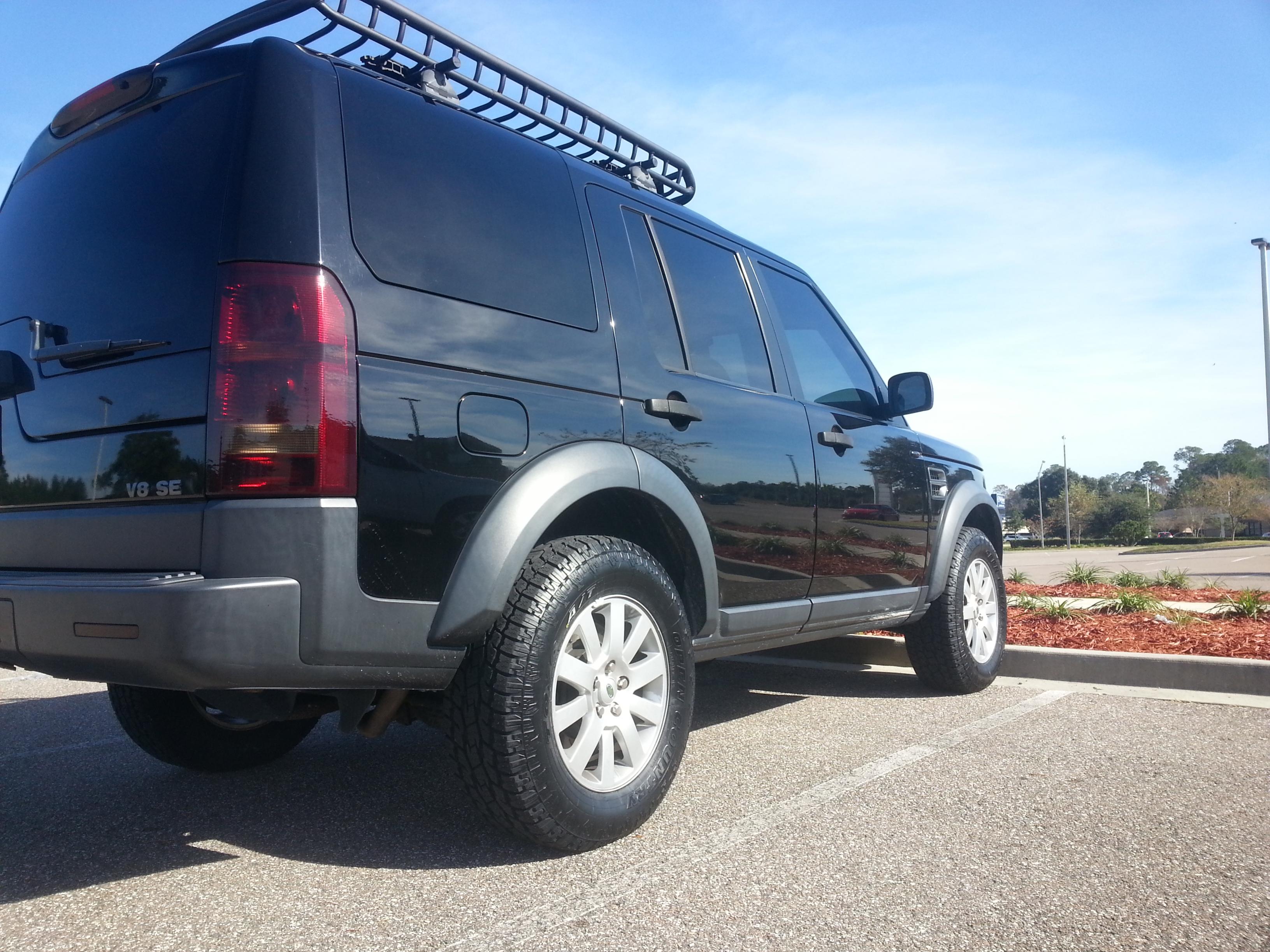

Ok, I'm in the process of ordering 5 new Compo wheels, 5 new TPM Sensors, and now I'm looking at tires. Most everyone seems to be using the 265/65/18 wheels which measure out at about 31.5x10.4. Has anyone tried an LT275/65/18? I'm not pushing for a bigger tire, just curious.
It should be around 32.1x10.8. I'm changing because the redbourne wheels along with 275/55/20 at 31.9 rub like hell, so I'm not too interested in any rubbing. I plan to keep at least 50mm of lift in place once I change the tires, so that may help. Right now I'm torn between the Toyo ATII and the BFG A/T. Both are great tires, but the price of the Toyo's may win the race.
Any thoughts???
Sounds like you have a great plan and ideas ahead... I just recently went with the 265/65/18 Toyo ATII's and couldn't be happier. Haven't been off the pavement yet, but the value and cost is what sold me. I think its tough to beat but then again I'm anticipating some of you going larger and hearing the experiences!!!
