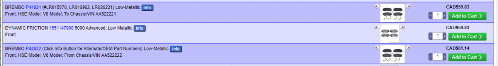

For those of you with 2010s there is a vin break with regards to the front pads required. It seems most manufacturers ignore this and I am not sure what the differences are but if you are experiencing strange issues perhaps this is a place to look. Here Brembo mentions it:
According to Brembo the earlier vin pad is 18.4mm thick vs the new part which is 18.6mm. Not sure if the earlier calipers cannot accommodate the thicker pad or what the deal was.

EBC also offers 2 different front pads / part numbers for the LR4. I wasn't sure what the difference was. 0.2mm thickness difference is almost nothing... gotta be some other change as well? I forget if MicroCat showed anything useful.
1,403
I bet the early pads were for easy install on the assembly line.
