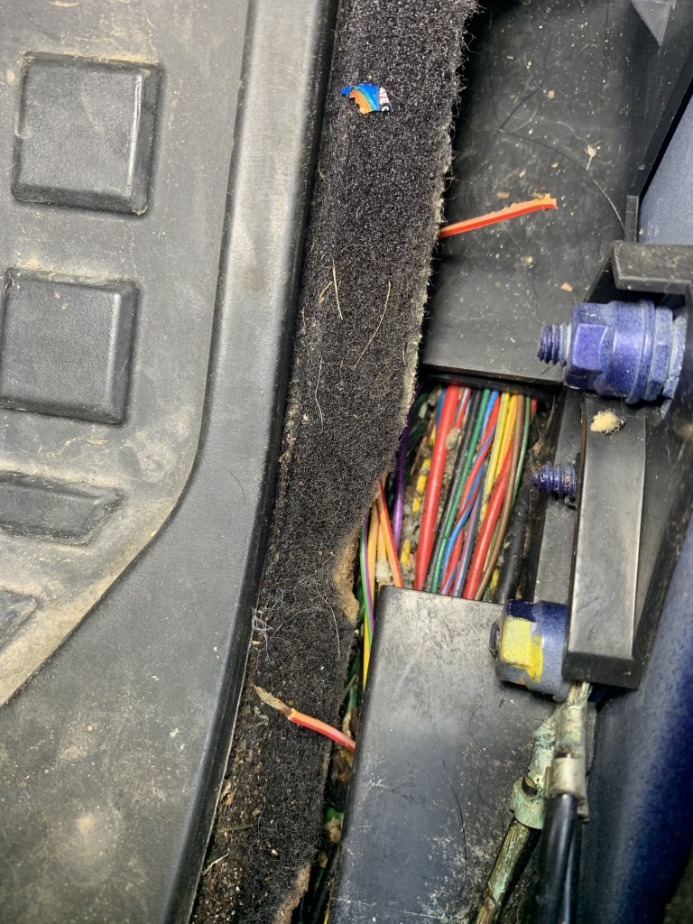

I randomly found a broken wire in the passenger side kick panel. It seems that the wire broke from a constant rub point. I had no clue what this wire was for, and made a separate post. Today I noticed the lock is now working. Maybe that was the problem?

Is that wire pink and red? Wiring diagram does show a pink and red wire for the master lock coming out of the BCM at that side of the car. You could cut it again and then you’d have your answer for sure.
That’s good to know. I searched everywhere for a wiring diagram, but could not find anything.
