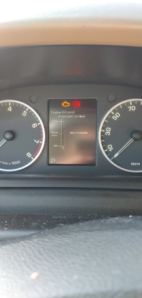

All, first time for me and a couple of questions. I only got a little over 6 liters out of my 2012. I put 7 qts back in. Anything to worry about? Here is the readout from my oil check.
Thanks in advance
Thanks in advance
Sent from my LM-G820 using Tapatalk
It’s 8 liters. 8.45 quarts. You’re low man! [emoji6]

Well, I had a dealer change at 75k and I am changing at 85k but for all the pumping I did I couldn't get anymore out of it. The readout says full though but I don't know what "Not Available " means. Sort of confusing
