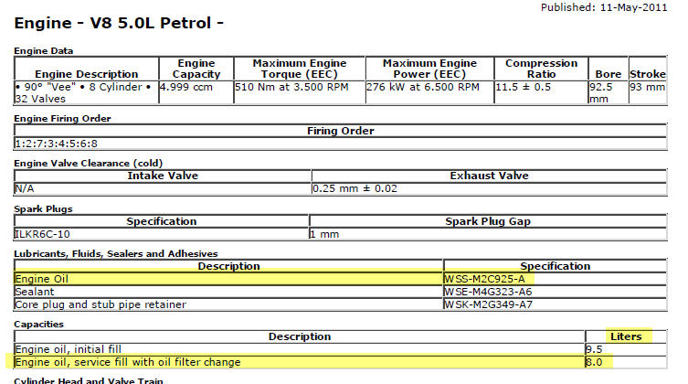

If I’m not mistaken, the truck takes 8 liters not 8 quarts. Not sure it’s enough variation to cause negative effects, but wanted to give a mention.

This is true. It's about 8.45 quarts. I have been putting in 8.5 quarts of Mobil 1 5W-20. Zero problems.

So that's 8.45351 quarts (according to google). Here in the US the oil comes in Quarts.

FWIW... I pour in 8 quarts (not liters) after changing the filter and draining the sump via drain plug. Actually 2 gallon jugs, which is easier than 8-9 bottles.
I think the 8 liter spec is max/capacity and it's safe to run slightly below that level.

gsxr
May 8, 2017
782
367
Big Sky Country
You are correct - the FSM shows the capacity as 8 liters. Screen shot below.
