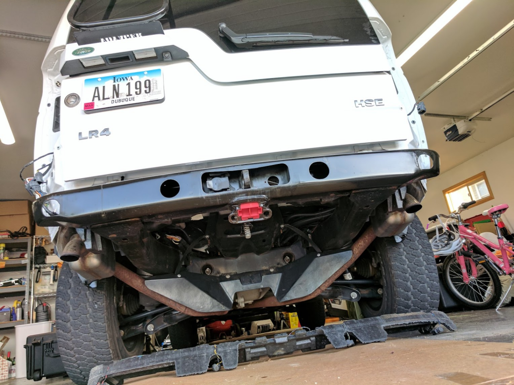

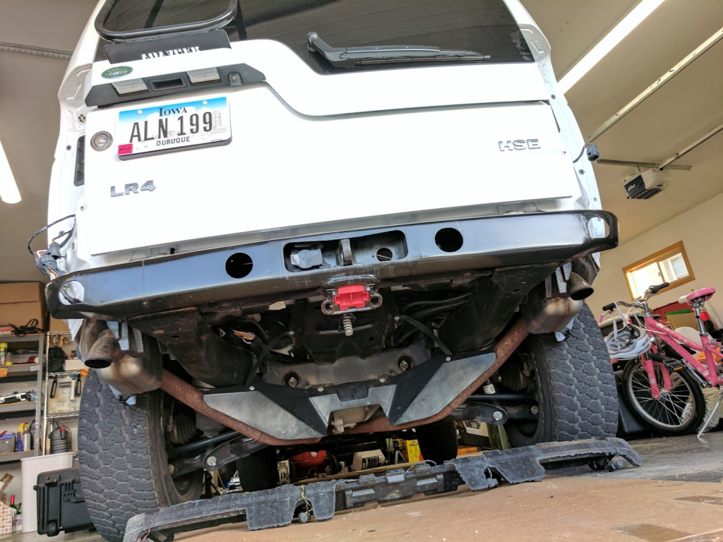

The T44 bumper is definitely DIY. And btw.. the longer we get from these things being new, the MORE I assume owners are mechanically capable and doing more work DIY on these things. These vehicles are not that complex if you get to know them and not that practical to own if you don't work on them yourself. Just get a friend to help you palce it on there and get it in place and slap the bolts in. Mess with the fender wells and your done.

Pretty easy to put on. However, if you're not comfortable doing it yourself and can't find anyone in the area to help (or who won't charge $1k plus), and if you've got some time, you could make a trip out of it...head to Southern CA to pick up the bumper and have Eric install it for a couple hundred dollars, then go hit some trails as there are lots in Southern CA. I was living in Northern CA when I ordered mine (bumper, tire and jerry can holder) several years back; I was planning a trip anyway, so I swung by the TR shop first to have the bumper installed before I ventured out.

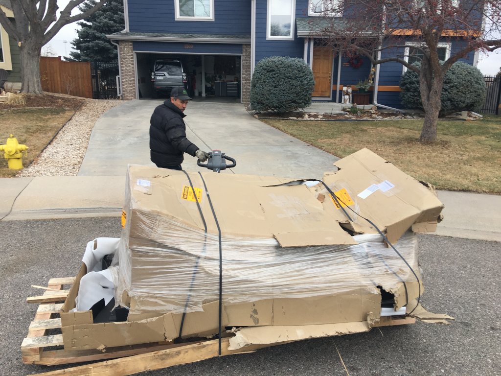

I bought a whole package from Tactical last July and it was delivered at the beginning of Dec.
Unfortunately the shipper was very careless, looks like they dropped the palette off the fork lift.
As I will be installing things outside, I need to wait for good weather (we have snow on the ground).
There are several places on each piece where the powdercoat was scratched, so I also need warm
enough weather for touch up work. I plan to do the installation myself with help from my brother. I
was a mechanic in the army so no fears of turning a wrench. There are gaps in the install instructions
from Tactical, but a LR4 service manual has helped with pictures and torque specifications.
Magus, if you care interested you can drive up to Ft. Collins to watch and help when I get ready to
do the installs.

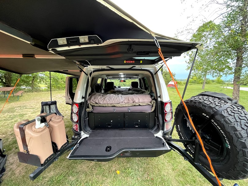

Is it possible to run it day to day without the swingout spare and with the spare back underneath? Then put the swingout spare back on before a wheeling trip or whenever?
I take the jerry can holder off once in awhile. It is pretty easy. One bolt and the gas strut and move the license plate. Takes maybe 10 minutes to remove or install an arm. Very reasonable to do that.
