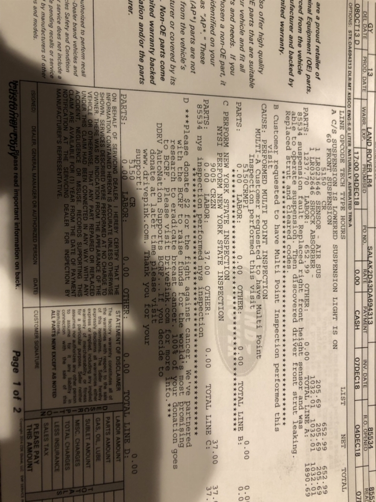

Highway robbery
1,858
$1,032 for the air spring is about $150 more than even the MSRP from the dealership: https://landrovermerriamparts.com/p...iteid=215719&vehicleid=378928&diagram=7117295
You'd think they'd cut you a break for having them do the work, but they cut themselves a break instead. Maybe the service manager has a boat payment coming up.
Wonder how many hours they billed for that job? Even at $250 an hour, there's no way it would have taken $652 in time to do that job.
