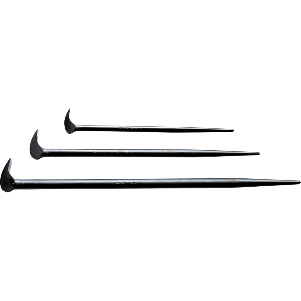

These work great for prying up on the super charger.
I believe it. When I was doing mine, I was afraid of damaging what I was prying on, and what I was using as a fulcrum that I couldn't see. So I ended up using straps and making sure that the fulcrum was outside the engine bay on a wooden frame. Abundance of caution and all.
