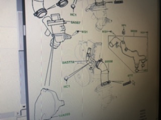

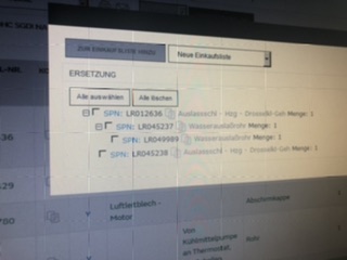

Just left LR. Here is the part numbers:
Little pipe with ******: LR049989
Pipe to throttle body: LR045238

@CodyJay glad you figured it out. With mine being an '11, I had to swap both hoses to these updated version when I did mine.

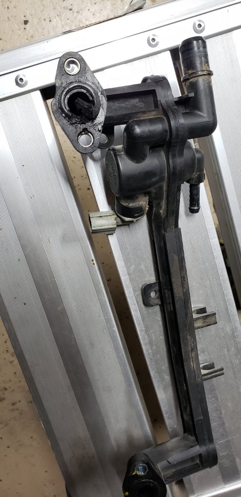

@scott schmerge Thanks for pointing me in the right direction. I found the leak. Looks like the rubber deteriorated on the left side. Getting those screws off took some work. I'm good now. So, thanks again.

Why would I repulsive the crossover as it’s behind the water pump? Not sure I see your logic here
Because it’s virtually impossible to put in the new hose without removal of crossover pipe...speaking from experience. I also broke the elbow when replacing my water pump and had to replace this hose.
djkaosone
'11 LR4 HSE LUX 5.0L V8
Oct 26, 2015
1,073
742
SoCal
I second this. I too did the EXACT same thing and I'm 100% sure there are others.
I've done it without pulling the crossover pipe, but it's pretty damn difficult to put the thermostat back in. Not impossible, but it sucks. Pulling the crossover pipe is the correct way of doing it and while you're at it you should replace it at least once in its life.
