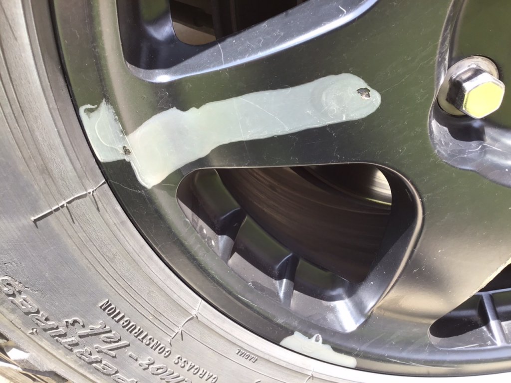

Well, my Comps are just over 2 years old and I’ll tell with with 100% certainty this has nothing to do with chemicals. For one, I’ve never applied so much as a wheel cleaner to them. Just automotive soap from the same bucket after washing the rest. They’ve also never seen a spinning brush car wash...only touchless.
I do off-road the truck, And you can distinctly see the rock chips which started this mess. The worst spot was only half that size prior to me washing the truck a week ago. I could press on the spots and see water move underneath the delamination.
I have one or two quarter sized spots on other wheels too.

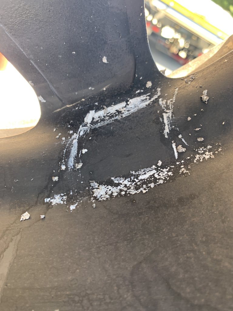

Not only are most of mine delaminating (I have 6) but two just developed pin hole cracks on the inside next to the spoke. I was informed by Barry that this is due to under/over inflation however I don’t go below 35 psi (long story). He offered me two new ones at a slight discount (which I accepted as it was the better option than replacing 6 wheels although I do like the Corsa ones). I think it’s a manufacturing defect but am not an expert. Anyone able to chime in?

Wow, that’s terrible. Is he saying its caused by underinflation to the point you’re hitting rim on rock? I’d be interested to know what Barry considers to be overinflated.
How long have you had them, and how much off roading have they seen? Not that it should matter - they are supposed to be built for it- but just curious.
El Solis
Aug 31, 2014
141
I’ve had them since mid 2017. They’ve seen between 2-3 thousand off road miles. 90% or more was fire roads and nothing really technical and no rock crawling. I run 35psi off road in the rear (the affected area) and 50psi on road as I have my drawers and gear in the truck full time. Just had the tires put on the new ones. Nothing obvious on the insides of the old ones. No signs of a crack or where the tire might have impacted the area. In the last 4 years the truck has only travelled 40-45 thousand miles total.
