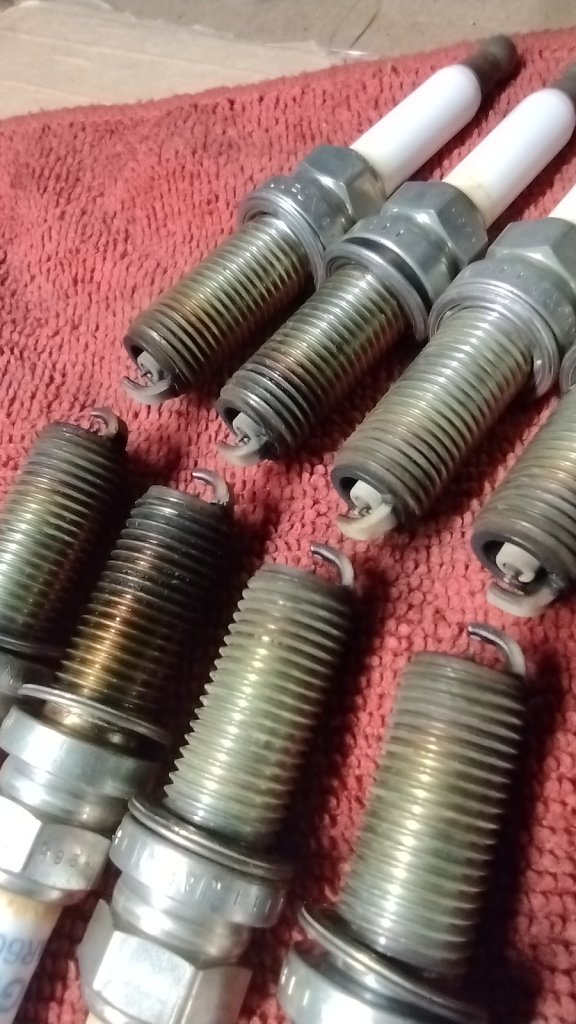

Got around to doing plugs on the new to me lr4. It looks like new spec is one colder. At 137k Likely the ngks in there were original as they were "6's", now they spec "7's".
I have run a tank through it and it looks like mpg dropped. Anyone else seen this?

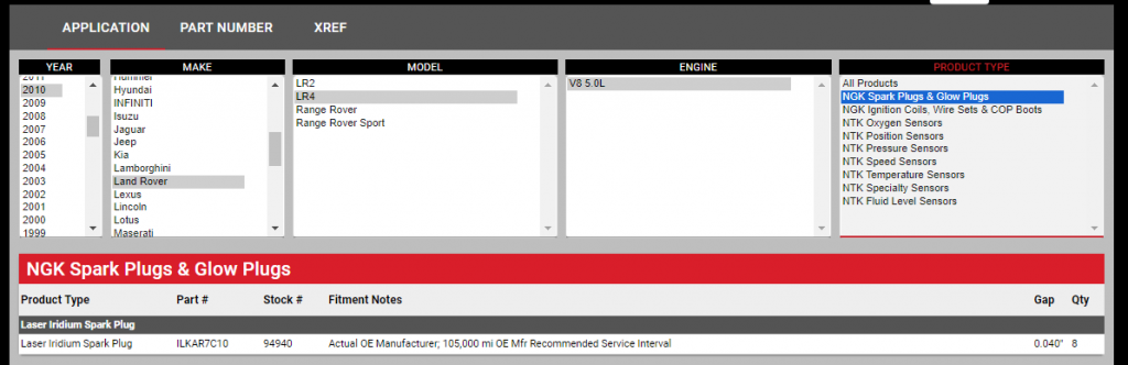

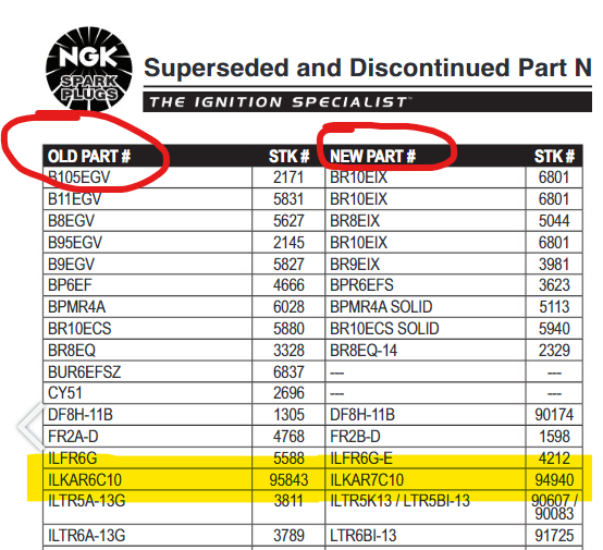

What year LR4? My originals in the 2010 were NGK 6C10 and the replacements were 7C10. At some point in 2011 LR started using 7C10s. I thought 6C10s were NLA?
Poking around I can see NGK discontinued the 6C10s and replaced with 7C10s. You either bought old stock (possible) OR you may have counterfeits? You didn't buy off amazon or ebay did you? Lots of fake plugs out there.

OMW... looks like LYSDEXIA strikes again.
6 came out, I put 7's in. I'll fix the original post.
But they looked good. Viewed as they would be in relation to driver seat (lhd.) lower left is closest to driver.
