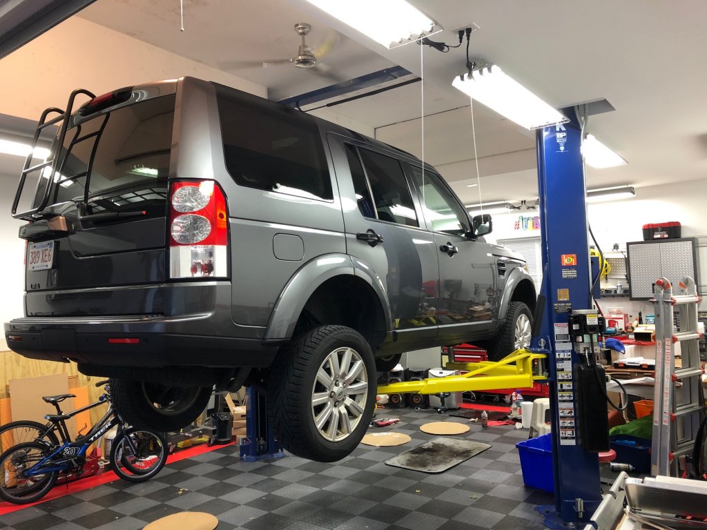

Also, an updated photo of my (supper messy) garage with the LR4 up on the lift. I was trying to spot my coolant leak at the time.
Note the cardboard discs under the tires: The LR4 is so heavy and has so much suspension travel that if I just lower it directly on the Racedeck tiles, the tire angle puts enough lateral load on the tiles to unsnap-them and create a wave of tiles. Ask me how I know. It was a PITA. So with the cardboard disks, the tires just slide into position. An alternative is to soak the area under the tires with water, but the discs work bets and create less mess.

Thanks for your input on my other brake thread. Also, your photo made me miss my Stornaway Gray 2011. Man I loved that color. Santorini Black is cool but I've always loved deep gray vehicles because they always look clean between washes. Your rig looks cool on the lift.

Thanks. It's shown there with the winter wheels/tires. The rest-of-the-year wheels are the factory black package 19" wheels. I will be throwing out the OEM Contis this spring and putting on new Terraincontact AT Conti's.

I know a lot of guys love the black pack but I'm a fan of the alloy finish. I have these same rims on my 2013. Also a fan of the TerrainContact A/T's since I got them in December. I've put 5K on them since then in a mix of around town, 1,350 road trip to VT, and a bit of snow driving. I like the way they perform and look so far. I've got a couple of intermediate-level trail rides coming up this spring and will report back on how they do.

Yeah I love the color o the one in this thread and with grey paint I actually prefer silver or aluminum accent trim and wheels. Our Audi S4 avant is Dolphin Grey and the silver and gunmetal silver wheel sets look perfect, even 11 years on now from new.

Uuggh. I wish I had that much height in the garage.
I have a lift I use to stack cars, but limited to 10 feet so the Rover can't get very high.
That is a nice setup.
