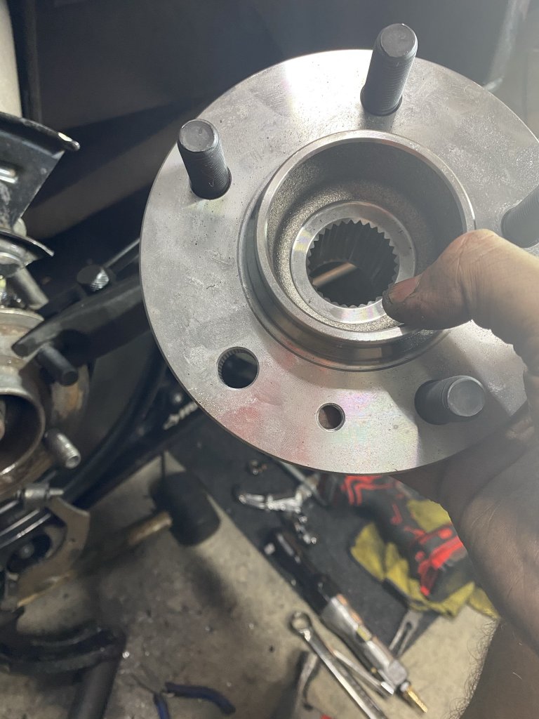

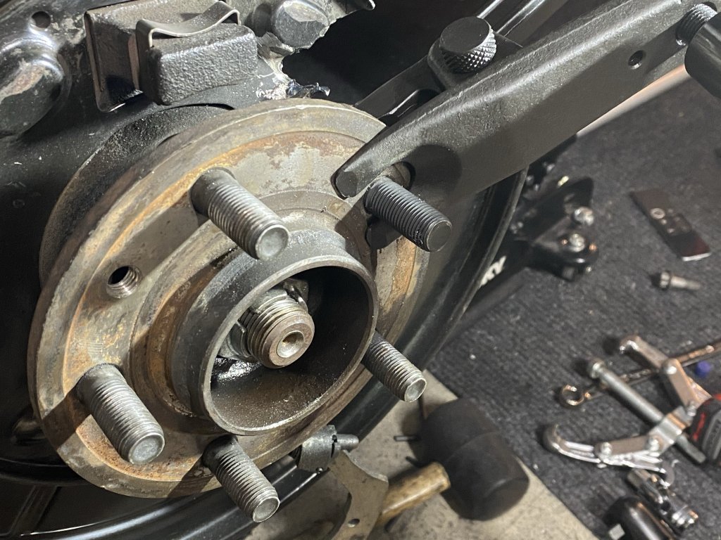

I ended up buying the hub from Lucky8 (which wasn’t the entire assembly) and instead of pulling the hub apart and potentially compromising the bearing, I pulled a lug stud out and pressed it into the hub on the vehicle.
In the end, I’d recommend to anyone that they replace the entire hub assembly for like $250 (aftermarket) before going through the mess I went through.
For extended studs, I’d just buy all new hubs, press in the studs you want, then put the new hubs on the vehicle.
