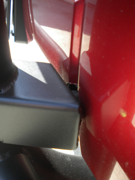

Well after a minor mishap with a nut...(I started an entirely new thread called brush in with brush bar... see for details) it's finally on. I took forum advice (thank you) and drilled a little lower than recommended. it worked out great. I believe I drilled down 80 MM. I hope you can see by the photos that the hole around the long bolt and spacer turned out as clean as you could expect for cutting a 1.25" dia hole into the plastic bumper cover. that wasn't the hard part, I had issues with the nut that is tack welded inside the bumper, came off. what a nightmare. on the instruction booklet step #4 directs you to keep a 20MM gap in order to easily slide the bar onto it, but that did not leave the bolt threaded onto the nut very much. as I pulled the par down to attach the bottom (due to a snug fit) the welded nut sheared off. My recommendation would be to screw the long bolt in farther than the directions recommend because getting a new nut in there was a HUGE pain in the ... anyways, all done and here are some photos. thank you to all who gave advice.

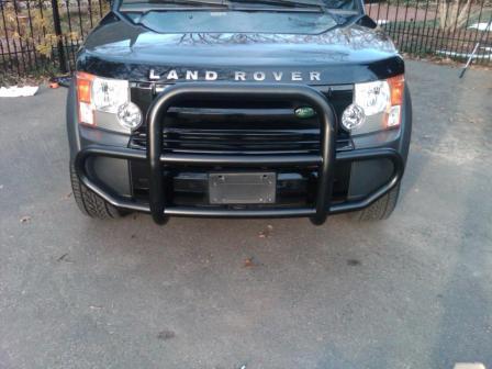

I slightly cheated. I already had a 1.5in hole saw (38mm) so I just used it instead of buying a new one. Driver side hole I hit dead on, passenger was just a lil off center not exactly sure how, but it went on no issues. I meased the exact 70mm/2.75in and no problem. I did what you did, tried the 20mm gap first, took it off then tightend it some more and was ok. Thing is on there like a rock. I drilled the holes, test mounted, washed it, put it all back on. Just need lights now!
