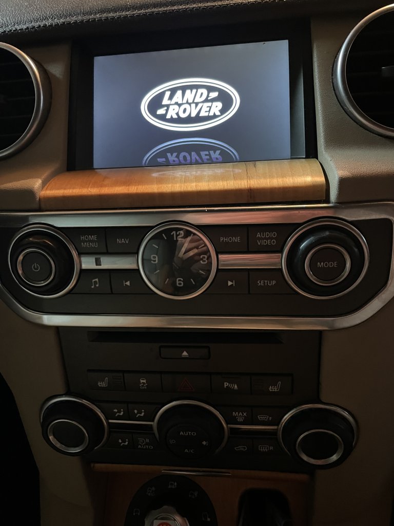

You lose the CD player and the 4x4 screens (tho you still get a little view on the main dash when in 4x4)
You gain a sharper screen, features like car play and android auto and a much snappier response time. You also get a Sirius XM option. The sound seems better as well, tho with the same amp and speakers, it can’t be that noticeable.
You pretty much get what’s on your phone but on a bigger screen - I like to use Waze a lot for example. Your phone can sit wherever you like but the head unit screen is nice to work with
this looks pretty cool and worth doing, here's my LR4 (2013) photo. What does doing this retain in the OEM stuff and what does it lose? Cheers JimView attachment 13211 I use the GPS mapping quiet a bit. I use the CD also. I have
