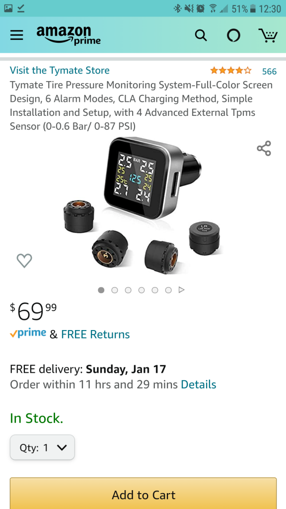

I'm mounting my Tuffants next week and have the same Kaymar rear setup except reversed. What TPMS option did yu go with?

Also curious about TPMS option for the TuffAnt steelies. I should have mine next week.

This is what I use. OEM tpms stayed in the OEM wheels.
