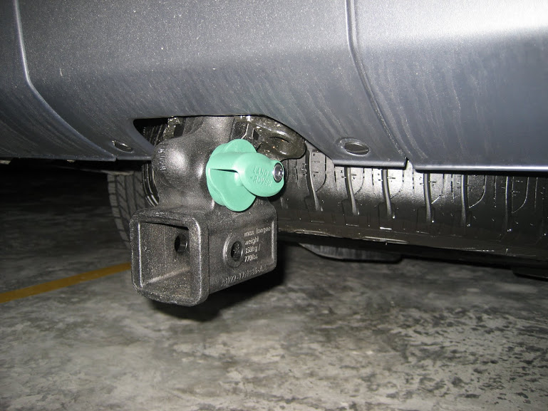

You should make a habit of removing the hitch when not in use. OEM or not.

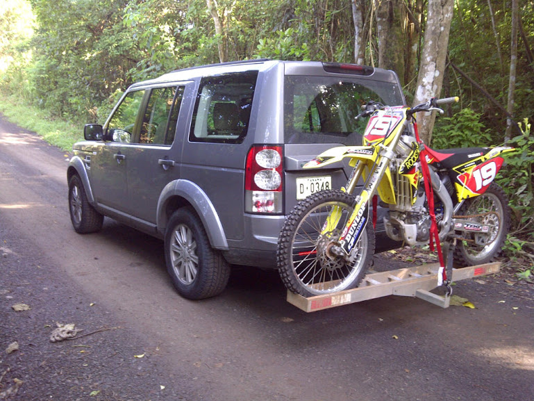

I also have the OEM hitch and it works great with a motorcycle carrier:
Bike and carrier must weigh about 270 lbs

I don't know what is "wimpy" about the AB hitch. It is very solid, mounted in about 10 minutes. It works fine with my motorcycle carries and I tow a heavier (400 lbs) sport bike. For $300 less you do lose the convenience of the snap-in/snap-out OEM model but not much else.

The only issues I had with the OEM hitch is that it's to far in for my Yakima Stick Up tray style bike rack. When the trays fold up, the front tray will hit the bumper so it needs to be removed in order to fold up. Second issue also related to how far the hitch is underneath the car is MTBs with longer handlebars will hit the windshield. I tie a small face towel on the end of the handlebar to avoid shattering the windshield. Etrailers sell hitch extenders in different sizes that will eventually purchase.
