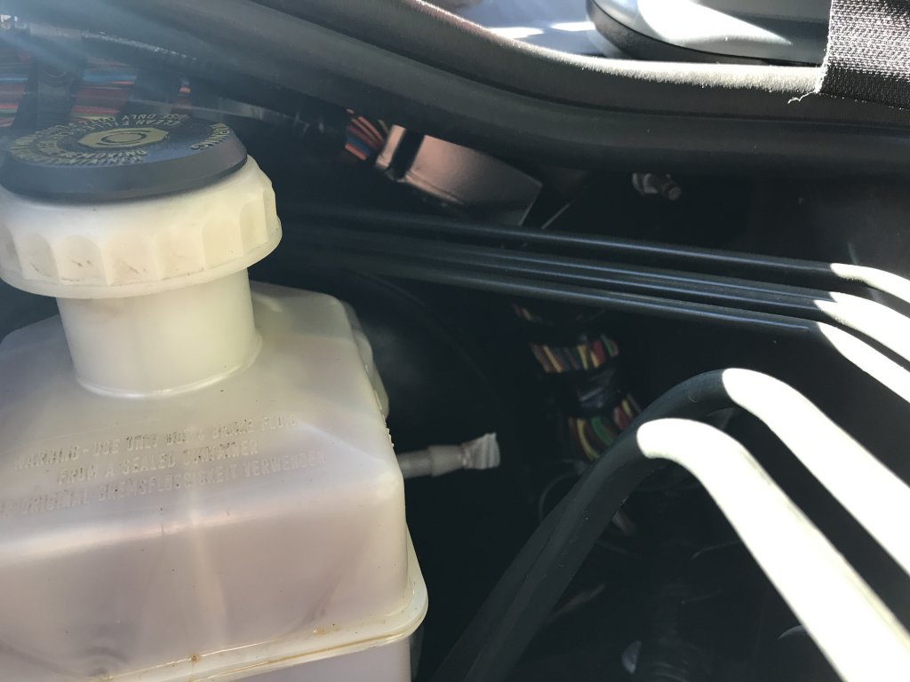

OK, my dashboard is stripped out, but I can't find a usable pathway to route the GPS antenna cable through the firewall. There is a rubber **** in the top middle, but that opens out to the back of the HVAC box and I cant access it from inside the dash.
There is another rubber **** with wires beneath the brake booster, but when I poke a wire coat hanger through it, it doesn't go through into the cabin, seems there is a L shaped turn with another **** on the inside that I can't route through. How did you do it?

There is a rubber grommet high up in the firewall just to the right of the master cylinder.
There is some insulating padding on the other side of the hole.
You will need to pock a hole through this padding to get the cable into the cab. I used a screwdriver to do it.

I just attempted this. There is no way I can get anywhere near that grommet. There is a huge wiring harness and brake lines running right in front of it and I can't even touch the grommet with a long screwdriver, let alone get a hand to it. I installed my GPS antenna to the top of the windshield next to the mirror. My unit had a few issues on arrival. The power cable had a crossed pair of wires that I needed to switch around in the connector block and the Android box was set to boot in Russian, so I had to google how to change that. The vendors in Australia were pretty helpful and quick to respond though. My unit is up and running with Waze, Google Maps and Navmii so far. Also loaded my skiing apps and a couple of others. Next job is to work out how to interface the AUX output from the Android box to the AUX input of my head unit. I couldn't find anywhere to plug them in.
