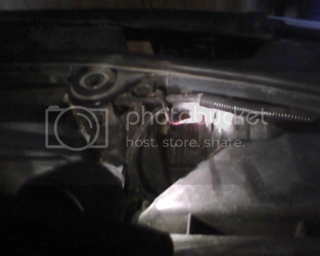

I also had the 'bonnet open' msg and the alarm would go off whenever I locked the Rover. Thanks to the members here, it took me 5 min to unplug bonnet switch and add a piece of foil and the 'bonnet open' msg was gone.
Standing next to the fender, taking picture toward the front. The switch is underneath the left side,passenger side, hood latch (standing in front of Rover). Unplug the latch where the thin wire are and the flashlight is hitting.

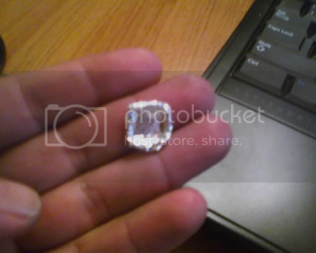

Then add a piece of foil and you're done. It worked for me. No more 'bonnet open' msg.
I'm back. had to replace the foil. This would have been my 3rd time but I broke the connector. Not the hood switch, but the electrical connector, the piece of plastic that locks it to the hood switch. So now the connector doesn't lock into place.
